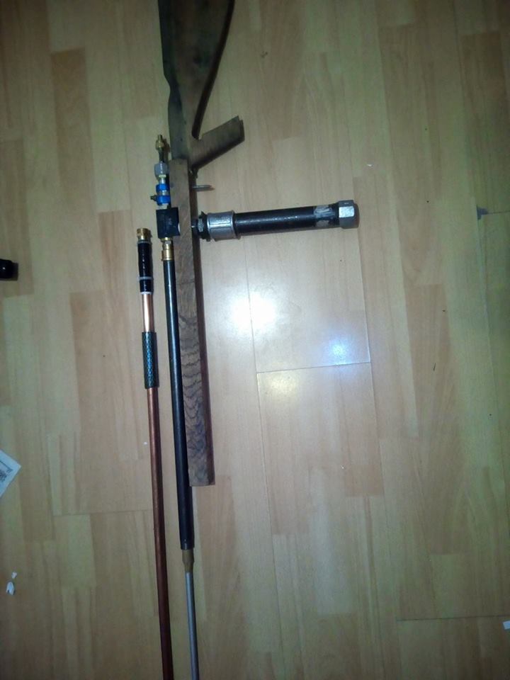

Modify blowgun for better flow.
Anatine Duo wrote:Modify blowgun for better flow.
That would be a way to optimize it but there's probably some restriction here that we're not seeing. At 120 psi he should be seeing good performance regardless given the chamber size, barrel length and QEV.
That being said, 8mm counts as "small caliber" in the spudgun world and 120 psi is relatively low.
Here is a GGDT model guesstimated from what we can see in the thread:
10 ft lbs isn't really that much, heck they'll let you own that in the UK without a loicense!
I think Haniball1337 should be looking for a higher pressure source, maybe a fridge compressor as popularized by his fellow countryman.

Haniball1337 wrote:that china qev would be able to hold 450 psi?? Air blowgun is for 12 bars , qev for 8 bars
While exceeding the manufacturer's specifications is never advisable, QEVs of this design have been taken beyond 500 psi by the members of this forum. As to the blowgun, this will be too hard to operate at this pressure so a ball valve pilot would be a better idea.
Will Beto SP-002AG 28bar shock pump be able to pump 28 bar to chamber or this is fake? and this will happen
Your chamber is too large for a shock pump, it will take you forever to reach 450 psi.
Your best bet is an airgun pump like this one, alternatively a fridge compressor is a way to get that pressure easily and cheaply as per POLAND_SPUD's tutorial.
If i will put bigger chamber i will get more power?
Not really, more pressure is the solution. Alternatively, if this is not an option, consider going up in caliber. If you keep the same setup but change for a 19mm barrel firing 0.75" steel balls, you will get double the muzzle energy.

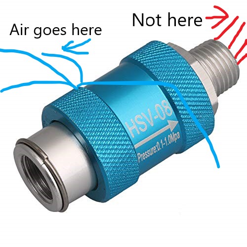

Slide valve is good too but , how is this working? He have compressor Hooked up and he is shooting all the time ? Can someone explain me ,
The slide valve simultaneously shuts off the air supply from the compressor and vents the pilot to the atmosphere, here's an animation by clide that explains it quite clearly:

So if i will do that it will work? (This is bicycle valve ), If i good understand the air doesnt go behind the slide valve but from above? So if i understand it can be little better than that one with air compressor gun ?
Technically it's more like this but yes, you get the idea. It will work as you drew it.
