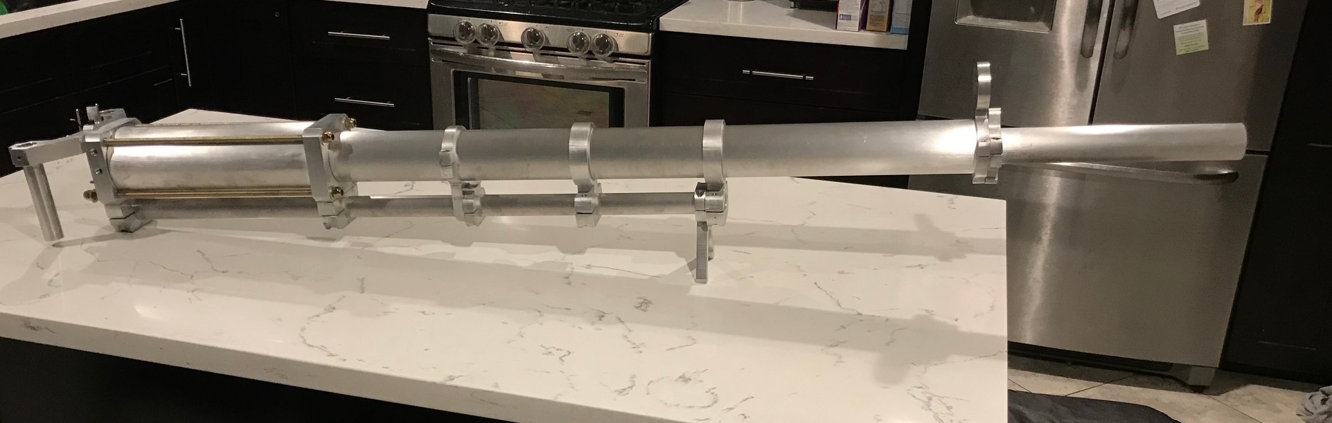

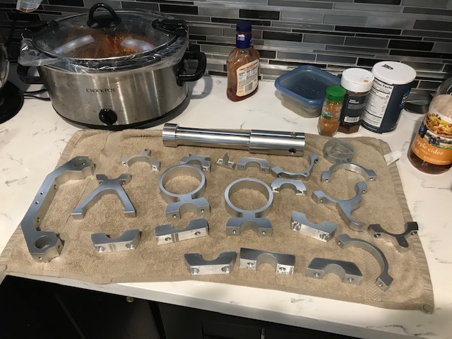

This is a build log update.

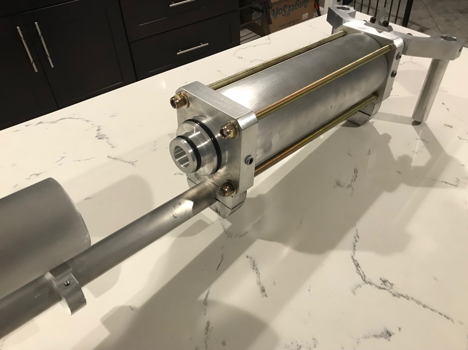

Hard at work tonight. Assembly going well. I had to turn an egg-shaped pipe to be semi-round with nothing but sand paper. Guess how hard that was. My next project is to buy a lathe and mill for the garage. That will take a while though, lol.

That's an understatement if I've ever heard one, looking great! Now let's hope she performs as well as she looks like she shouldMoonbogg wrote:It's looking pretty good...

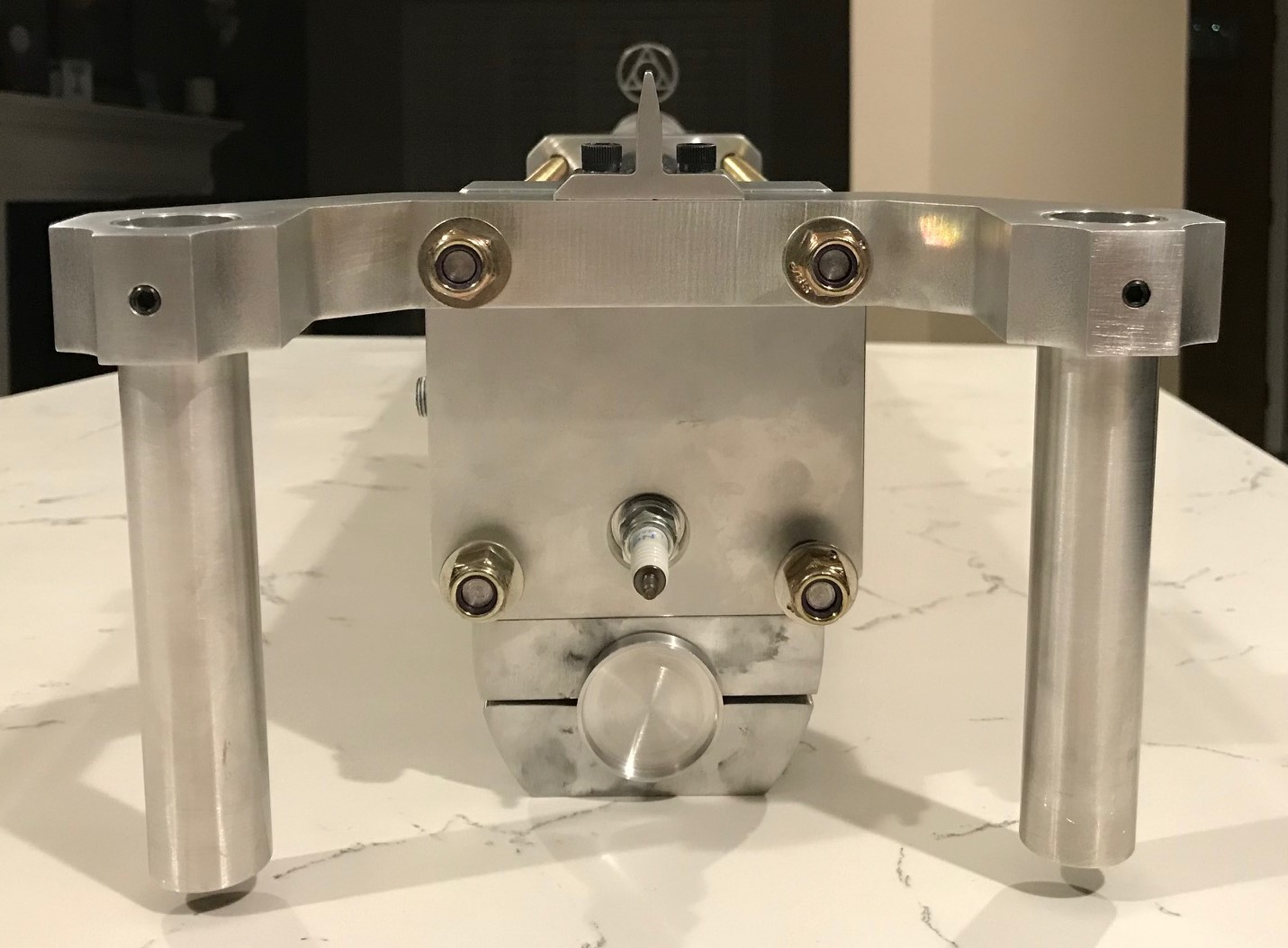

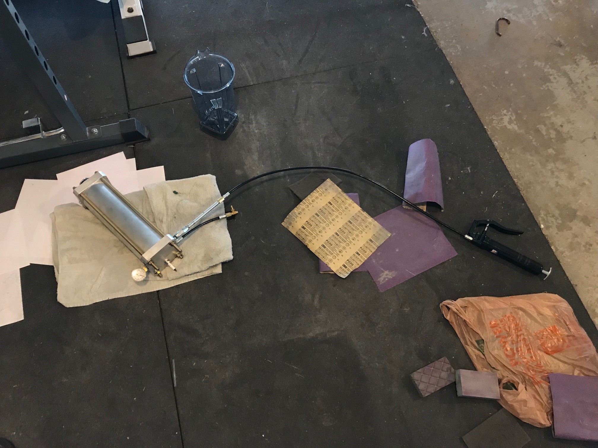

It passed hydro! I had to pump like crazy once it got past around 250psi because that needle valve was starting to leak. I kept going with my heart racing until it hit 400 and I kept going until 450psi was cleared. It only sat there for a few seconds and I went back to try to hold it longer, but I ran out of grease. It passed without as much as a leak. Not even the spark plug leaked and it only has a little teflon tape on it. Looking good!
Now I get finally put hydro behind me and get to finishing it.
I included a pic of my super sophisticated hydro testing facility. Take special note of the blender pitcher near by that was used to fill the chamber with water. Also, cleaning up all that grease was an absolute train wreck. What a titanic pain in the ass that was.

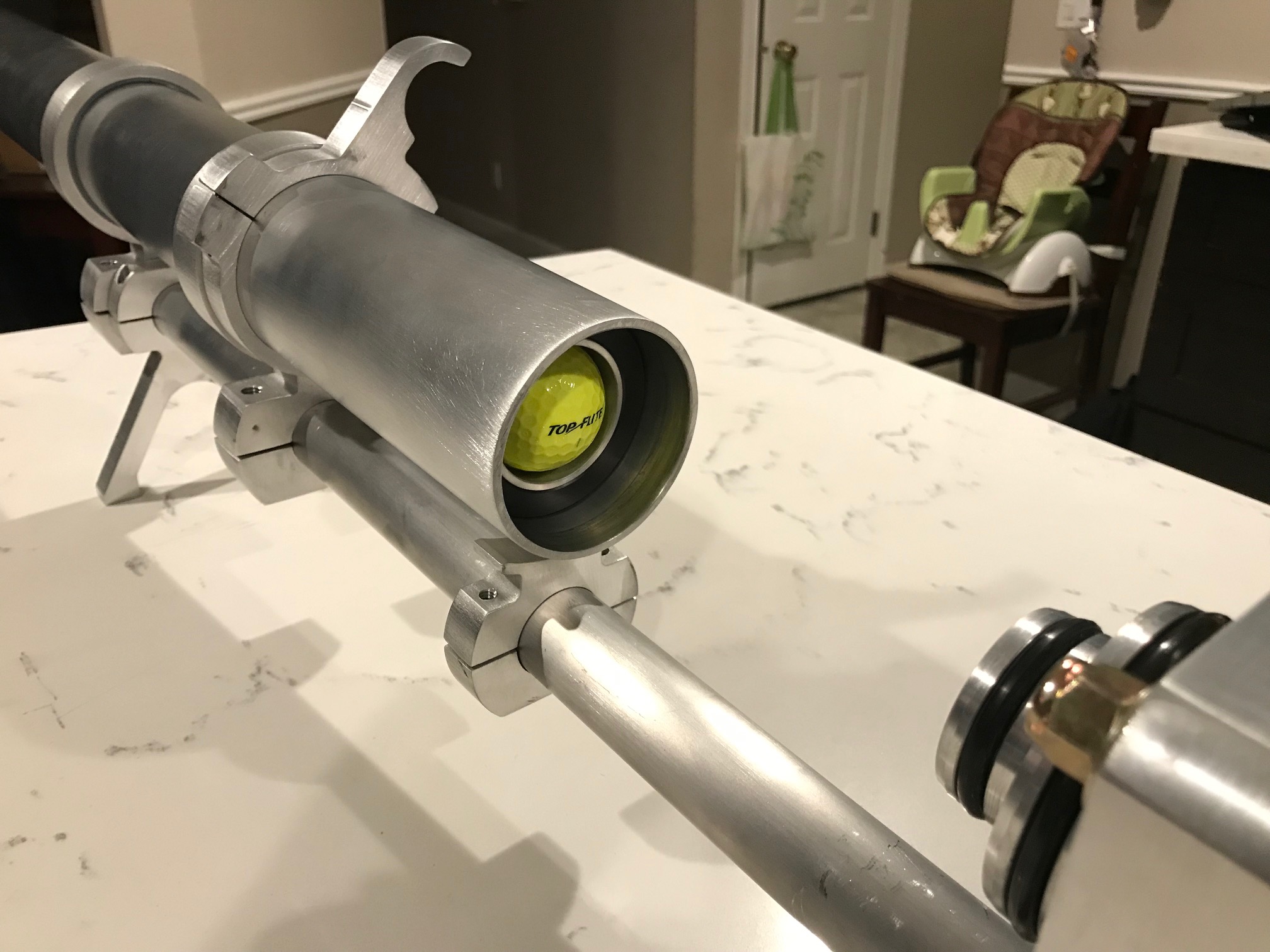

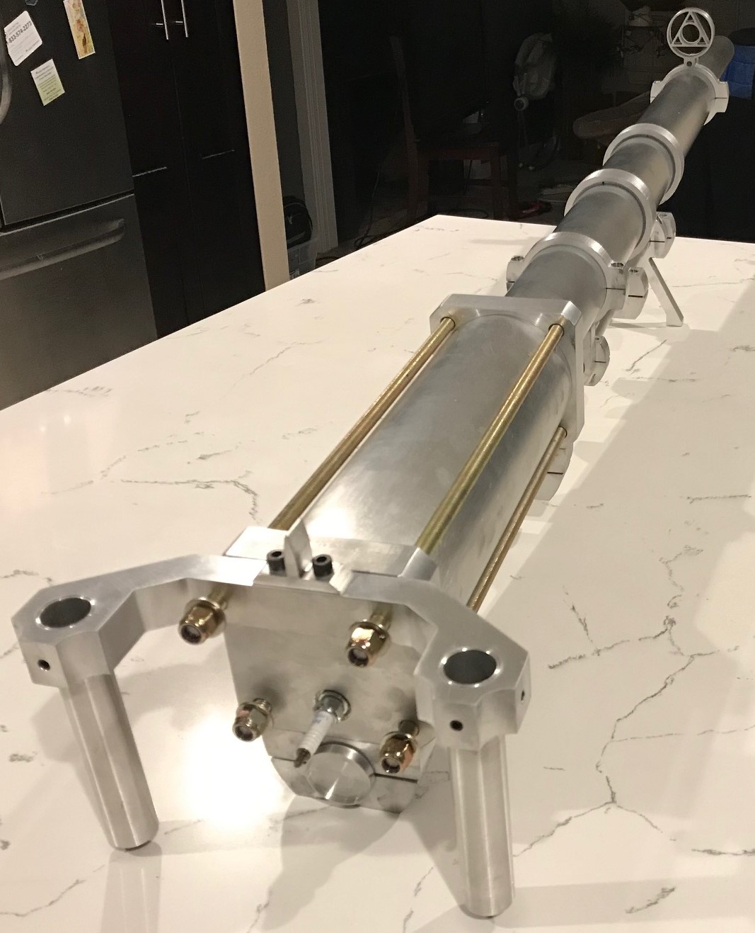

I've been super busy studying, but I took a minute to test the piston with air. Good news is the pilot area and chamber both appear to seal and hold pressure. When I release pilot air, the chamber air dumps out, so the valve works. The pilot area sat at 50psi for several minutes and didn't appear to drop. I only plan on using it around 20psi.
The uncertain news is that with a pilot pressure of 20psi, that should result in an opening pressure of around 135psi, but air starts to escape past the piston sealing face at around 50psi. My hope is that the volume of leakage is small enough to not wreck performance since combustion takes place so quickly that it may not matter much. I know some pneumatic cannons have air leaks and they work fine because the leak is small enough to not matter.
Of course test firing will tell but I'm curious as to your thoughts on this.

It's almost ready for testing. Regarding that, can you think of a quiet way to test a 3X hybrid in the garage?jackssmirkingrevenge wrote: Looking forward to seeing this thing spark.
