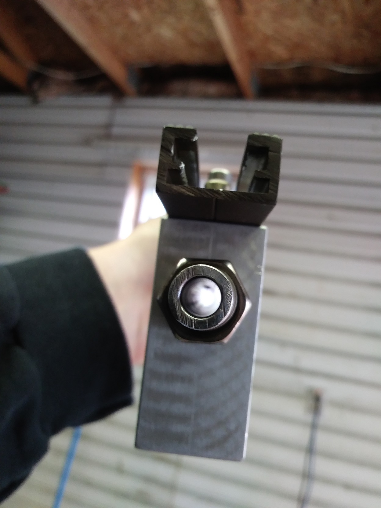

A bit of Sunday tinkering and it's in pieces.
Polished out the barrel and made hop up, to stop BB's rolling out as much as anything. Drilled down center of bolt and stuck in a piece of 'O' ring material with silicone.
hop up just visible down barrel.
Mainly trying to get better accuracy.

The hop up was mainly as a BB stop as I polished out the barrel until a 6mm ball bearing would roll down it, it had a couple of tight spots at the valve end. Also the loading piston clamped the BB in the barrel slightly so I lowered it, so now the BB's are free to roll forwards or backwards (made a back stop as well)
