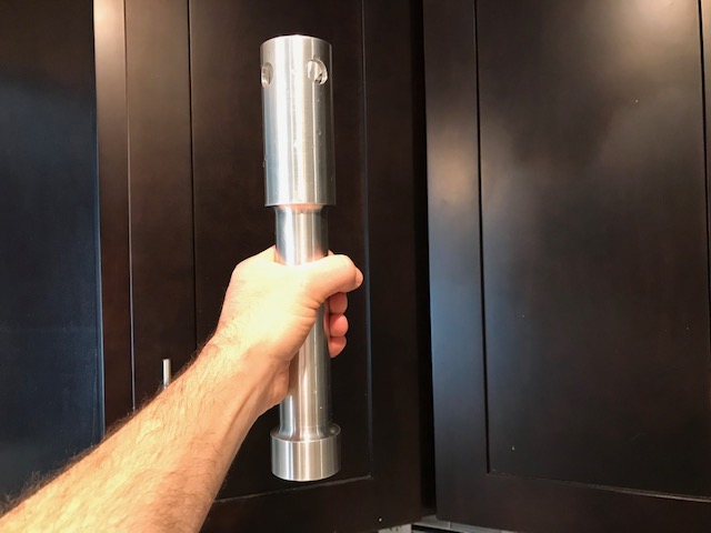

Thanks guys. Hey, what kind of valve could I use to release the 450psi water pressure after testing? A little ball valve? I'm thinking a needle valve. Also, if the thing passes the test, I could just cut the line with a hack saw...

Any kind of valve, or, as you say, just cut the line. Static hydraulic testing is done specifically for pressure vessels because you're dealing with [very nearly] incompressible fluids - failure is non-explosive. As soon as you've opened the vessel, there's no pressure left. If you do it with a compressible fluid like air, or if there is air in the system, however, failure is dramatic, to say the least.

It passed hydro! I had to pump like crazy once it got past around 250psi because that needle valve was starting to leak. I kept going with my heart racing until it hit 400 and I kept going until 450psi was cleared. It only sat there for a few seconds and I went back to try to hold it longer, but I ran out of grease. It passed without as much as a leak. Not even the spark plug leaked and it only has a little teflon tape on it. Looking good!
Now I get finally put hydro behind me and get to finishing it.
I included a pic of my super sophisticated hydro testing facility. Take special note of the blender pitcher near by that was used to fill the chamber with water. Also, cleaning up all that grease was an absolute train wreck. What a titanic pain in the ass that was.

I've been super busy studying, but I took a minute to test the piston with air. Good news is the pilot area and chamber both appear to seal and hold pressure. When I release pilot air, the chamber air dumps out, so the valve works. The pilot area sat at 50psi for several minutes and didn't appear to drop. I only plan on using it around 20psi.
The uncertain news is that with a pilot pressure of 20psi, that should result in an opening pressure of around 135psi, but air starts to escape past the piston sealing face at around 50psi. My hope is that the volume of leakage is small enough to not wreck performance since combustion takes place so quickly that it may not matter much. I know some pneumatic cannons have air leaks and they work fine because the leak is small enough to not matter.
Of course test firing will tell but I'm curious as to your thoughts on this.
EDIT: LOL first sign of semi-success ahaha. I did a pneumatic shot at 60psi and launched a stuffed toy lion across the house. I was like to my wife "Hey babe, watch this" ppffFFOOOMP! as it flies and hits the wall, lol! I have myself a SICK t-shirt launcher right here. It works perfectly as a pneumatic toy launcher.
