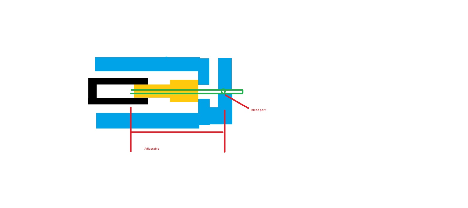

So the holy grail is to have the valve close as the pellet extis (or whenevr it's optimal) by adjusting the air flow through the equalization port (pressure raises on barrel side, air flows into the balance chamber at X rate and forces the valve close at Y moment)
Precisely.wyz2285 wrote:So the holy grail is to have the valve close as the pellet extis (or whenevr it's optimal) by adjusting the air flow through the equalization port (pressure raises on barrel side, air flows into the balance chamber at X rate and forces the valve close at Y moment)
The rule of thumb is to have the valve close when the pellet is approximately half-way down the barrel, any more than this wastes significantly more air for little benefit in velocity.as the pellet extis (or whenevr it's optimal)
- wyz2285
- First Sergeant 2
- Posts: 2390
- Location: Porto, Portugal
- Has thanked: 1 time
- Been thanked: 4 times
So if you make the valve stem length adjustable so the bleed port is half covered, then it's only exposed after the valve has open to a certain depth (AKA the needed dwell), closing the vavle in the right time.
Yes that looks like it would work.
