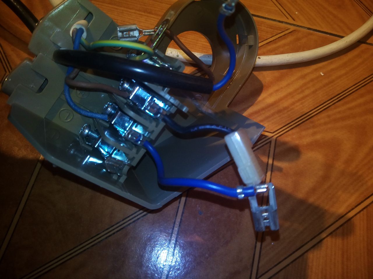

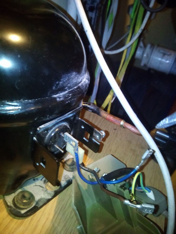

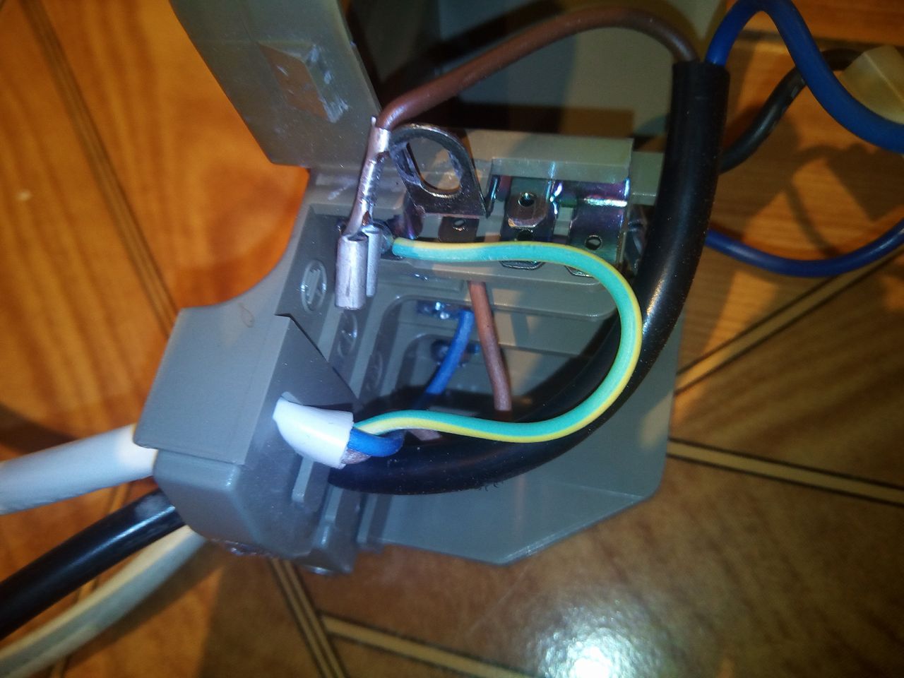

Hi , i bought fridge compressor , i really need your guys help beacuse it wasn't nearly cheap.I wanted to wire him but it dont work. first time when I tried it just start buzzing and compressor can't start. All tubes was crimped do i need now to cut them? I started to looking in internet how to check if compressor is dead and i found (on Poland Spud channel?) this
the test give me something like 17 , 22 and 40 so its good i think. On compressor i have capacitor. I tried something like this and it just make sparks but compressor wasn't starting. Why compressor don't want to start guys?
Fridge compressor dead?

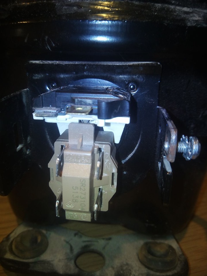

Yeah I was searching answer in that post but my electrical knowledge is poor. I found this symbols on my box. Crowley have inbuilt capacitor but my compressor has it outside so i need to know where i need to hook up him.

Mains voltage isnt something to play around with, or trial and error and i just want to let you there are potentially serious dangers here, its the second video in your first post that has me concerned. However you are doing the right thing by researching and asking others and have supplied a good amount of information to help us help you.
I have no electrical qualification so i can only advise you to wait until you find someone who truely knows what they are talking about before you try too much more.
i will say though:
1 stay safe around exposed electrically live metals, and dont trust the screwdriver handle will always protect you, it probably wasnt designed for electrical work.
2 the body of the compressor should be earthed for safety (the silver screw in the first image of your second post looks like a spot) this reduces the risk of electricity flowing through you if something is wrong.
3 read up about capacitor run induction motors (the motor buzzing is due it lacking a phase shifted pole, created by the run capacitor, this is what makes it start turning(the second video with the screw driver is a crude and dangerous attempt to create a bit of this effect). Also the buzzing comes from electrical energy being poured into the motor windings, with no output work being done this can heat up and burn out the motor meaning low torque and low output pressure)
4 check internet for a manual for the compressor. it might have wiring diagram
5 tube in 2nd image first post is the original refrigerant fill port. dont need to cut this.
good luck

I found this: http://mail4.ansal.com.ar/Documentacion/pdfs/576067.pdf there is diagram but i dont really know how to use it
- Been thanked: 350 times
Seems to me that if you connect it as intended and just bypass the PTC it should work, but I'm far from being knowledgeable when it comes to electricity.
