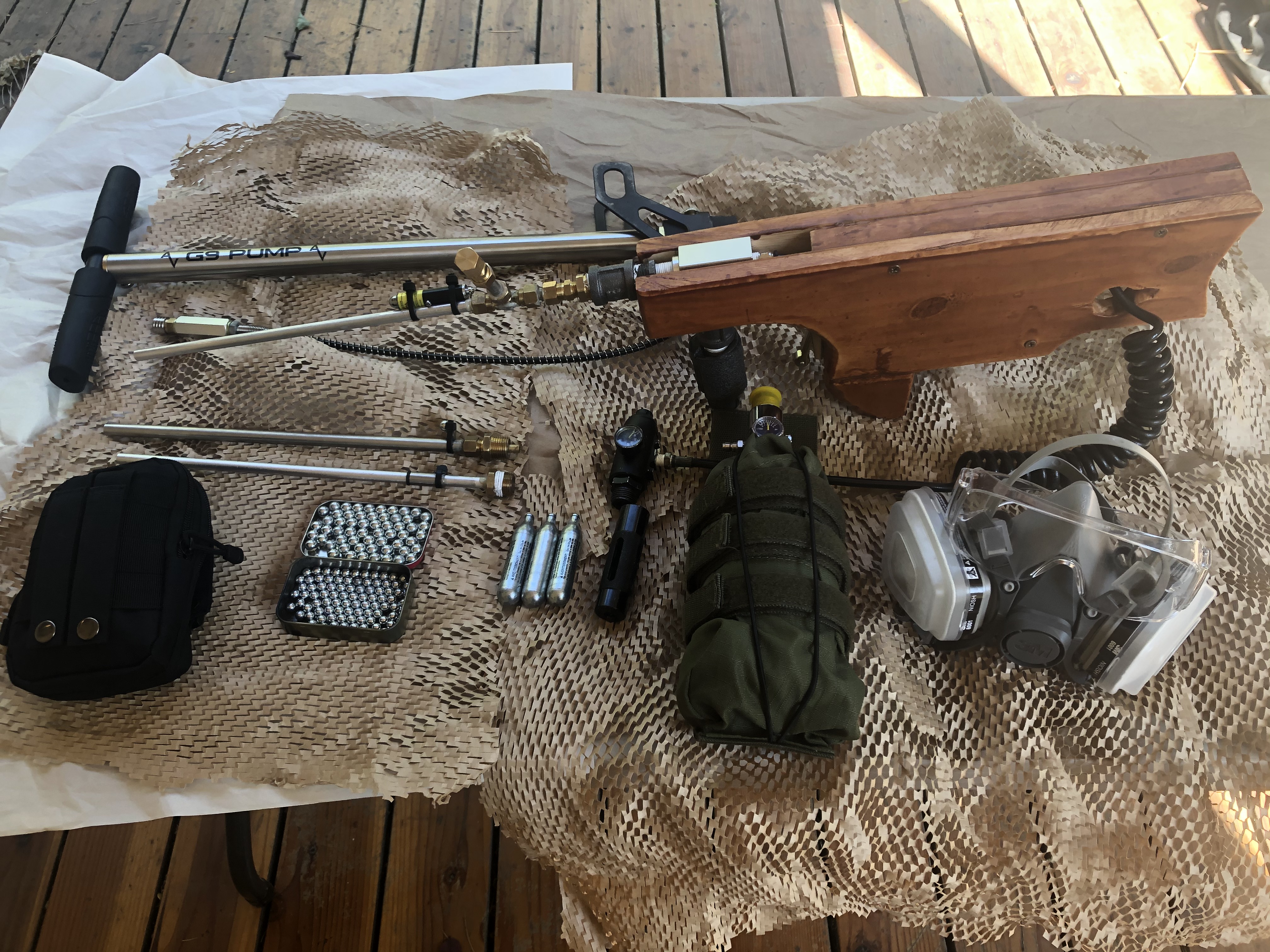

I also got another picture showing the completed cannon with all accessories. This gun continues to be an absolute blast to shoot, and gets fairly good gas efficiency. I get around 50 shots from a tank filled to 100 bar (1450.38 psi).
Still to come is a breach for the 9.5mm barrel and maybe a suppressor, although it's only slightly louder than a traditional pellet rifle. Maybe better optics than my hastily crafted laser?

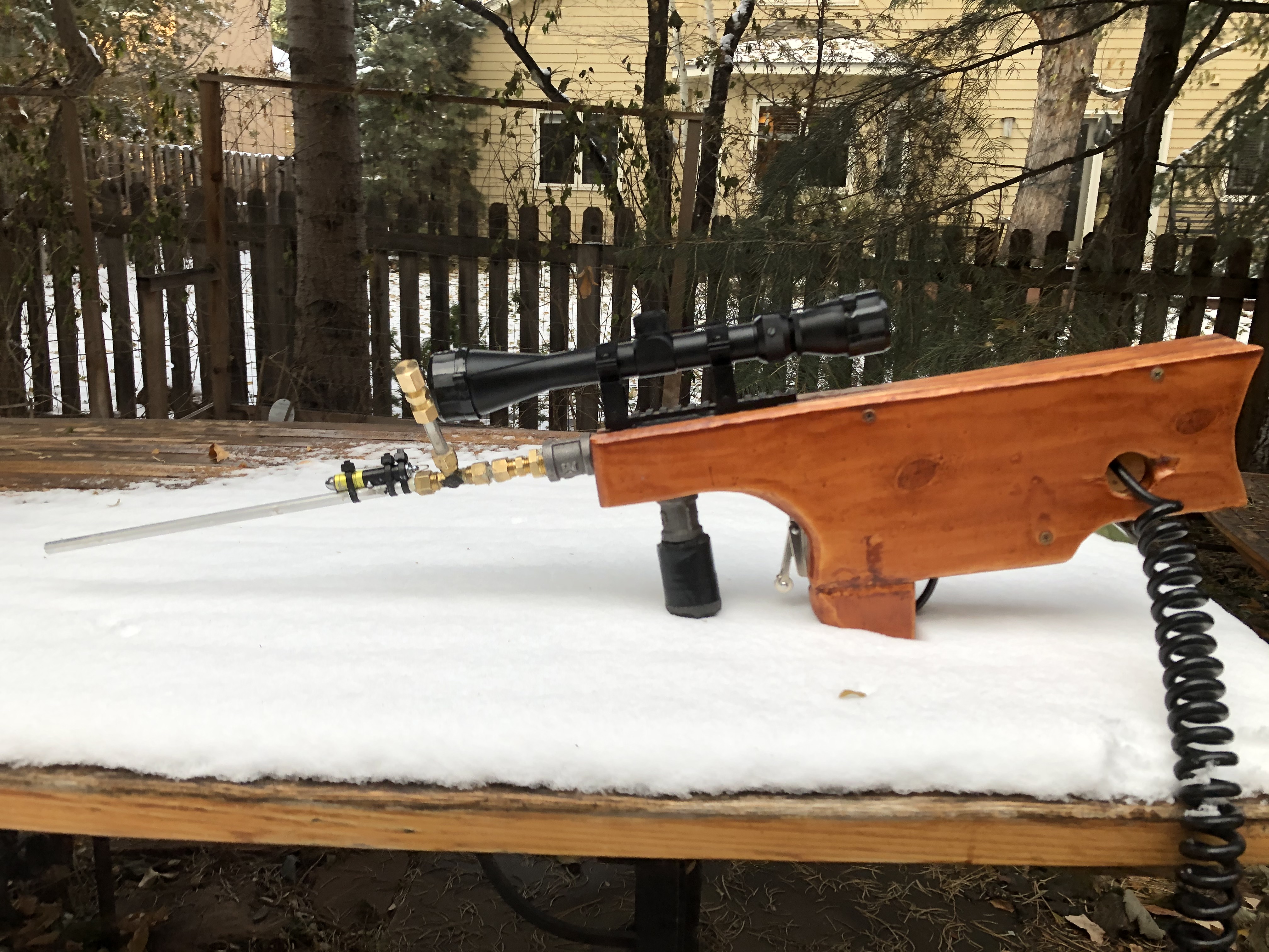

For example, I've added a scope, and a proper laser sight (not shown, on the other side) for greater accuracy at longer ranges. I've also added a proper bolt action/integral tube magazine setup for the 3/8 in (9.5 mm) barrel. The tubular magazine holds 25 shots.

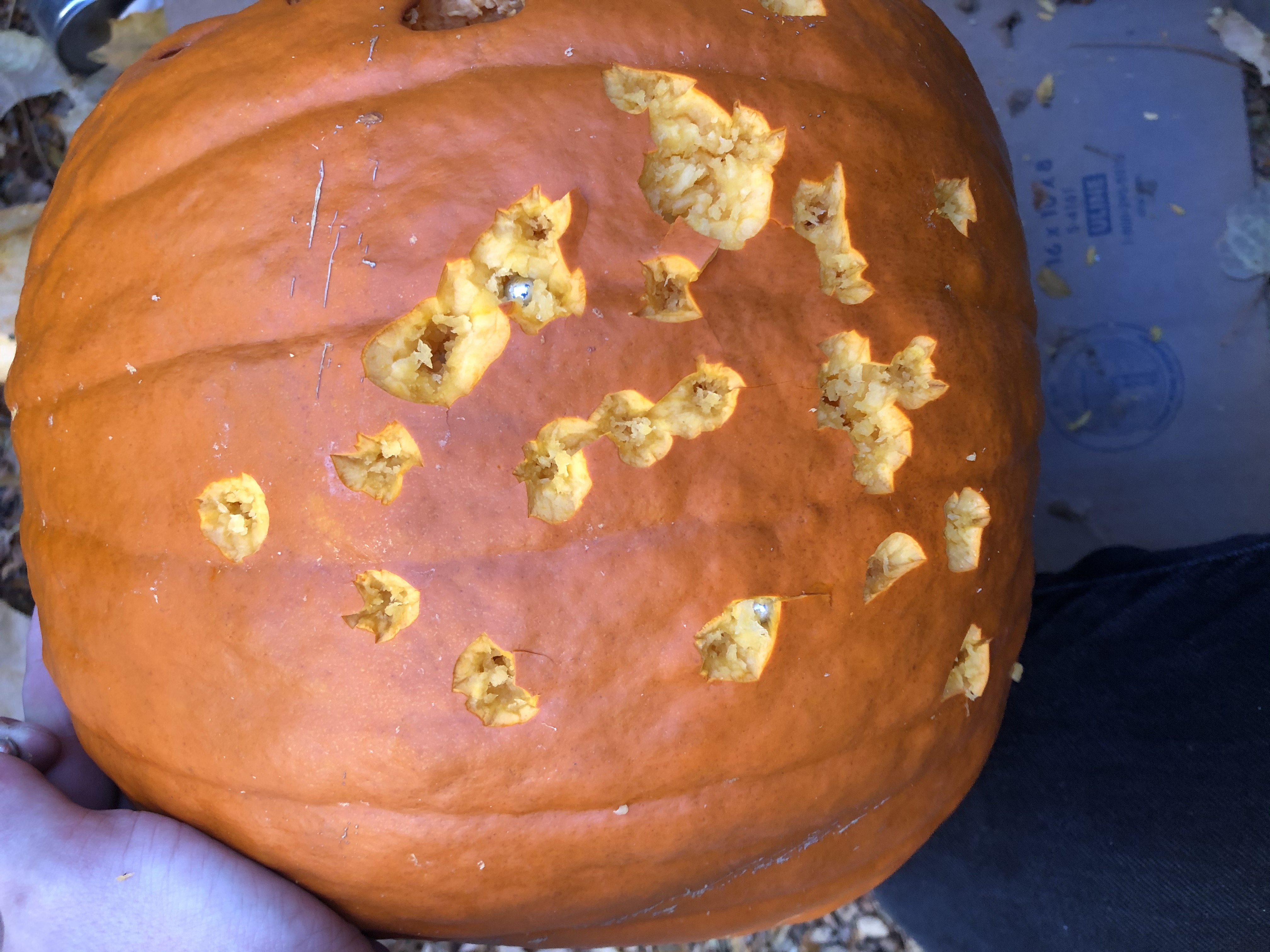

Finally, I had some fun with an uncarved Halloween pumpkin. Entry Exit
You can even see when I began to run out of air!
