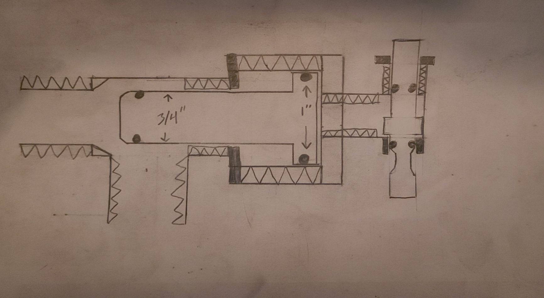

The "t" fitting that I use is a "street t" so it has one set of male pipe thread. The front of the piston sits inside the male threaded portion of the fitting. The back of the t has a 3/4-1" male to male reducer. The back of the piston sits in the 1" portion of the reducer. With out the reducer the piston would be balanced and would not fire on pressure differential.
Unfortunately this configuration only gets one shot per fill.. and with a hand pump 3000psi is a workout.
The guns performance is spectacular. The pilot volume is incredibly small. The trigger mechanism i created functions with a crisp "release" and it fires with a sharp bang.
I made A piston hybrid that uses this same piston/valve configuration. I like that it has a very small footprint.

I understand halfway ... sorry. :( Do you have a simple drawing? ;) if you don't mind, so that I understand the concept of the valve? I mean, not to use a seal on the face of the piston pointing to the combustion chamber, (hybrid), or to the firing air chamber, pneumatic).

Does this make any sense? Art is not a talent I have...
