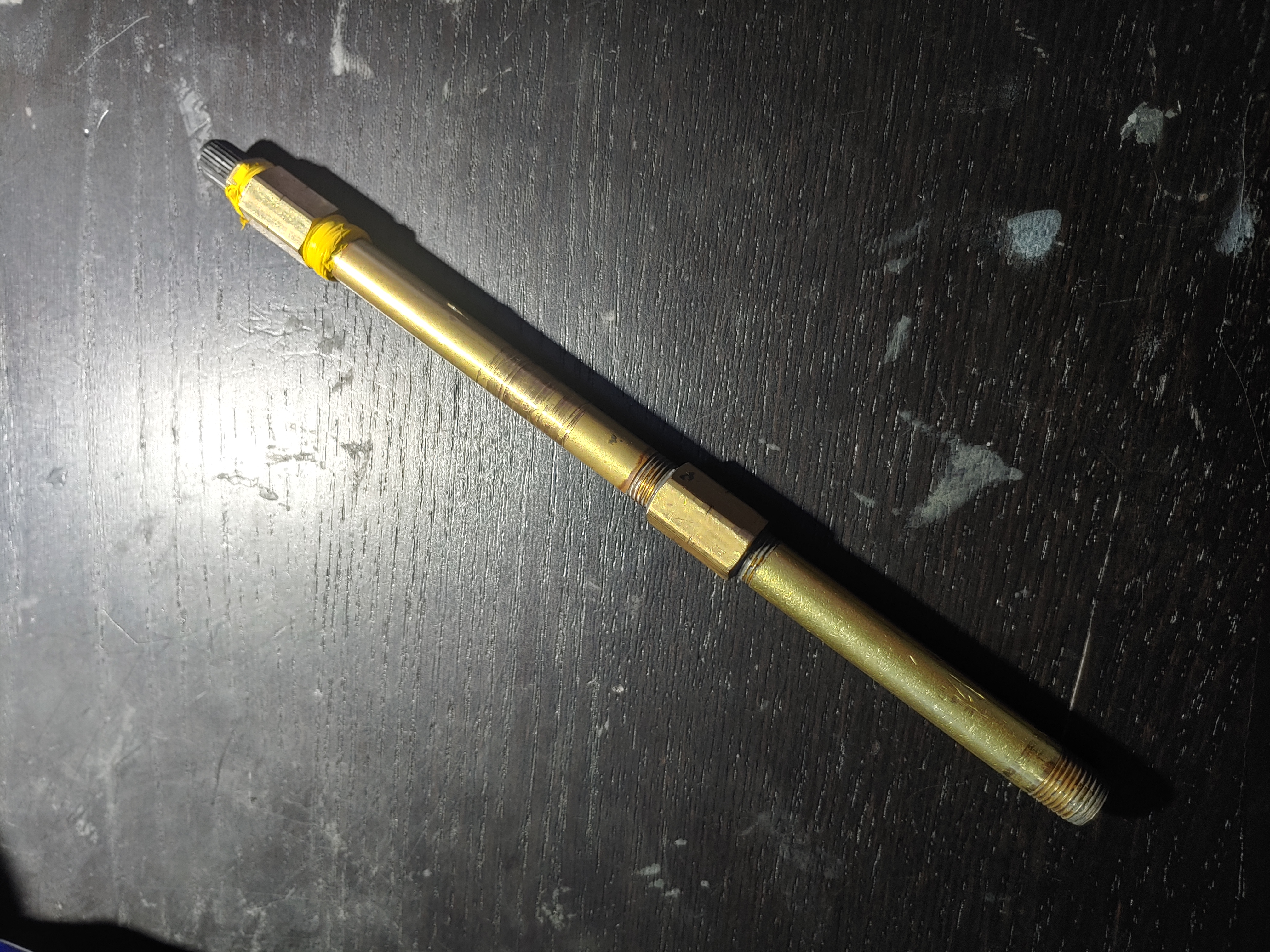

I have finally completed a simple coaxial pengun, yet another copy of a copy of JSR's design from so long ago. I'm very happy with it!
The build is made up of two 1/8" brass pipe nipples coupled together, with an OD 7mm ID 6mm stainless tube epoxied inside. Inside of that tube is the barrel, an OD 4mm ID 3mm stainless tube. The piston is a short section 6mm steel rod with a slice of 1/16" thick rubber epoxied to the top.
This is my third attempt at one of these damn things, mostly owing to struggles getting a proper piston made. Concern that my piston would not work is why this one is built inside of pipe nipples- the valve can come off and the piston can be removed for service.
The tube I ordered to be the barrel is supposedly 3mm, but 3mm steel ball bearings do not fit at all. Not even half of the bb will fit inside, so I am thinking it may be 2mm or perhaps 2.5mm. Any way to loosen the barrel, or should I just get new bearings? I would also love to hear other ideas for ammo.
Thanks for the guidance last year JSR. Took me damn near long enough to work it out though, what with school and everything else. The steel rod I eventually used as a piston was going to be a mandrel, to sharpen a piece of barrel cleanly enough that I could punch a proper piston out of rubber. Never could get one I was happy with.
I have been shooting it at 1000psi, but I might step up to 2000psi soon, once I receive some extremely high psi rated Schrader cores I ordered from an aviation supply
I would just get the right sized bearings, small nails with their heads cut off also work as PracticallySane suggested but only for very short ranges as they start to tumble.

PracticallySane wrote: Thu Dec 17, 2020 6:28 pm If you find some with the right size head, you dont need to remove it and it will apply some drag stability. I like the nails for hanging pictures.
I found a couple nails around my apartment... I have also ordered more ball bearings and tiny tiny nails which should hopefully fit. I will try and remember to upload a video showing off this thing in action once I receive them. I predict pretty good performance at 1000psi. So far I have only used it to startle my girlfriend, for which it works very well :evil:
I disassembled it and took the piston out and I must say, I am glad I made this thing serviceable because the sealing face is already looking pretty rough. Let's see how long it goes before I must replace it...
