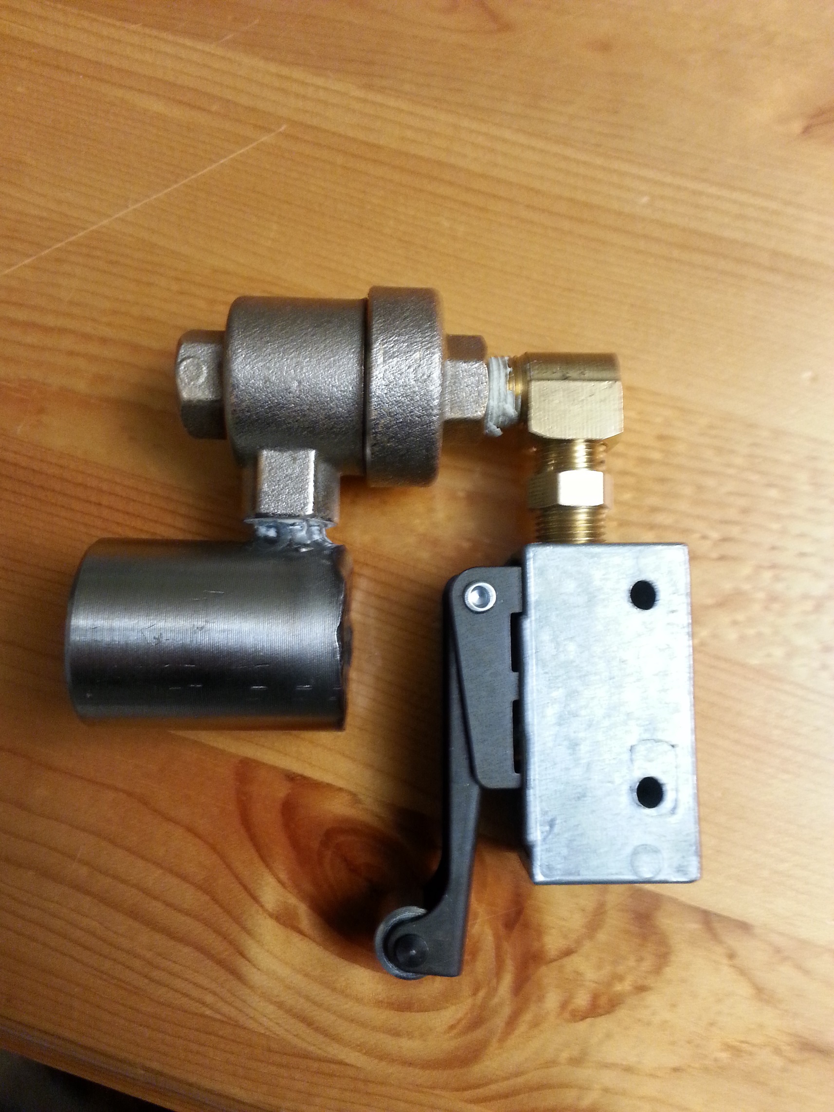

Those little 3/2 normally open lever valves make good triggers.
You should get good results with a barrel down to even 400mm
I got 860fps with 0.12g BBs @ 150psi with this, chamber is big, barell is 400mm

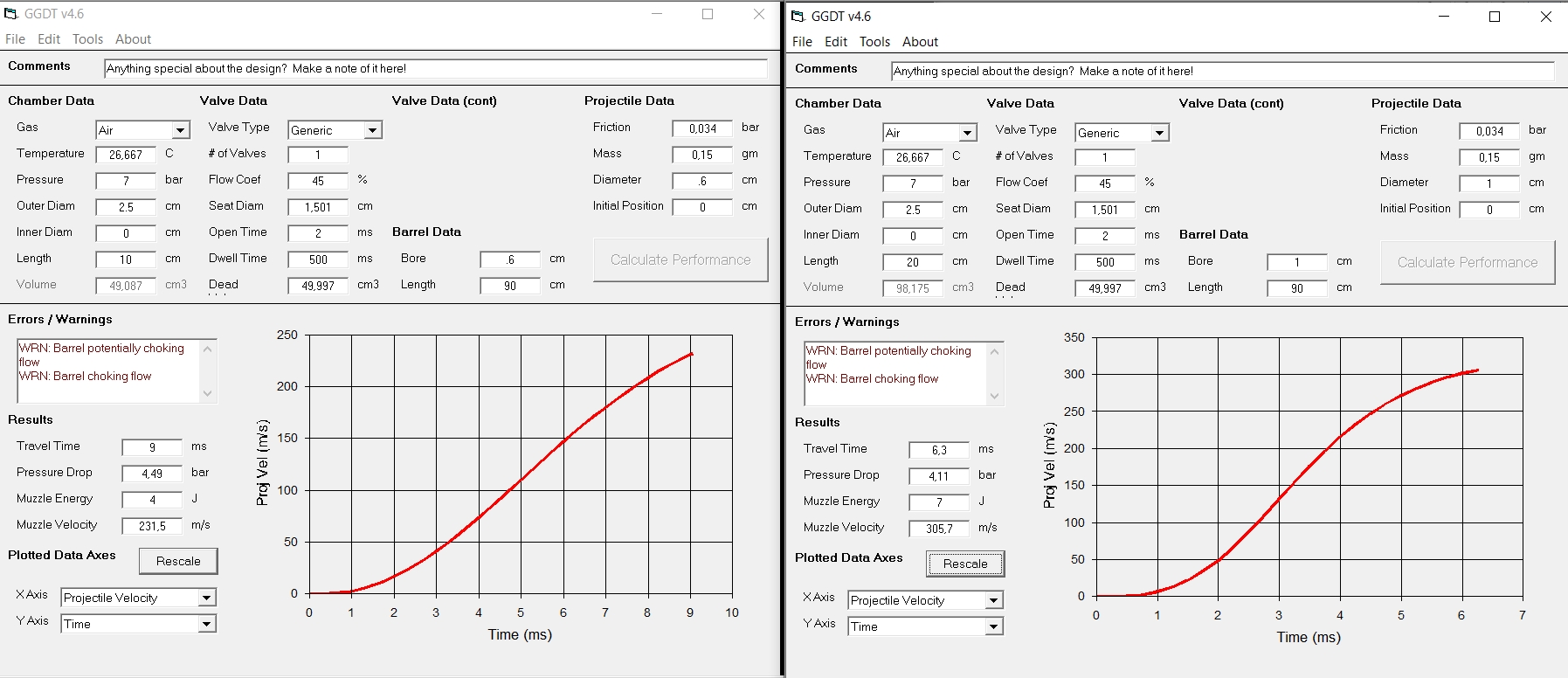

Hey guys, first of all thank you so much for your answers.
I managed to get a copy of GGDT (the site is unreachable, so I got it from web.archive.org).
Started playing with some simulation, one thing I wonder is: if I double the chamber length (so doubling its volume) and increase barrel diameter, do I get more energy and so a higher speed at the muzzle, at the expense of more air wasted? Just trying to get a balanced design
What is the "Pressure Drop" on the left? Is the "air" expended for each shot or the pressure remaining in the reservoir?
Sorry to bother the forum, all these things are new to me :cry:
thank you in advance,
Andrea
Anatine Duo
Canada
Posts: 191
Location: cottage country
Has thanked: 43 times
Been thanked: 21 times
I think that the pressure drop is for the chamber. When you see the warning about barrel choking flow it's a sign your chamber is too large for the barrel... should be nice and loud but maybe not the balanced performance you want.
Increasing barrel diameter nearly always increases energy, and velocity if projectile mass is the same.
Yes larger chamber will give more energy to a point, and also drop the pressure in your reservoir more.

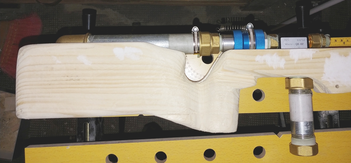

Work in progress.
Managed to make the stock (it took forever!) using two wooden board and a plywood board for reference, modeling and carving them for inletting the parts was quite hard with hand tools, huge respect for those who didn't use power tools and got pro results.
Trigger ready, I had to use two springs for the upper part 'cause the spring on the slide valve is quite strong and a single spring on the trigger couldn't hold the valva in place. If someone has a better design I would be interested, it's kinda working but maybe there are better solutions.
Cheers,
Andrea
Anatine Duo
Canada
Posts: 191
That is a lot of work!
Nice to see a mechanical trigger. Also the metal liner to hold the trigger and sear is a great idea.
There are several other ways to set up a sear to hold back the valve but would require almost total redesign. If you can get yours to work I would stick with it. Basically I would set up the sear so the pivot is at the far left. The slide will push the sear against the pin and be jammed until the right side of the sear is lowered. The trigger could be part of the sear but might feel weird.
It looks like you could eliminate the trigger return spring. The trigger side of the sear will press down on the trigger and hold it in place... I do that a lot in my designs (doesn't always turn out the way I think, but when it does it's an elegant solution)
We could start a whole thread on triggers... I have had a life long interest in them on crossbows, firearms, and spudguns.
