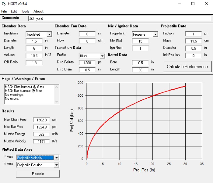

I am building a hybrid from a section of 1.5"ID stainless. The barrel will be .5"ID. The actual combustion portion of the chamber will be ~6" long.
From what I have read, nobody seems to have studied the impact of a blunt transition (imagine a 1.5"x.5" reducer bushing, with blunt walls exactly 90* perpendicular to the flow of the gasses), vs a tapered transition (elongation of this transition. Essentially like 'porting' on an engine).
--Blunt transition-I have read that, if anything, this blunt transition causes change from a largely laminar flow to a turbulent flow that increases the flame propagation speed. This sounds to be the very basis of what a high-mix hybrid would strive for.
--Tapered transition-everything I have learned about fluid dynamics suggests that a gradual transition allows for the highest velocity of flow at any given pressure.
So this brings me to my main question. I have machined the plugs for either end of my chamber. Currently, they are both of the 'blunt' design. I am considering 3d printing a 'transition damper' (essentially a piece that could be added in to smooth out the transition between the chamber ID and the barrel port). Would the loss of a couple CC's of chamber volume be more detrimental to performance than any benefit gained by the loss of resistance at the point of the transition?

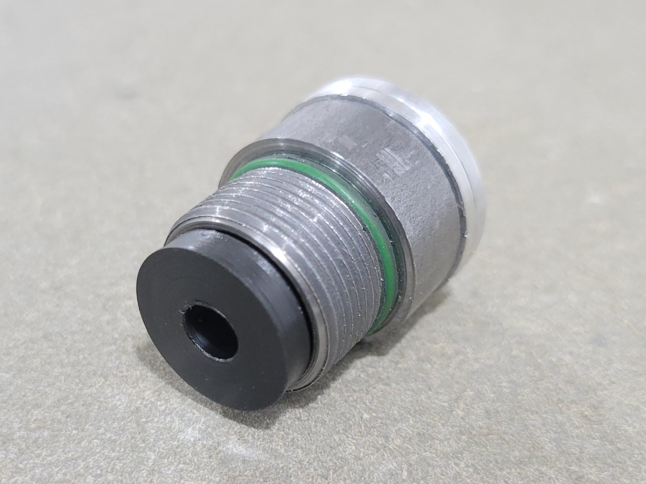

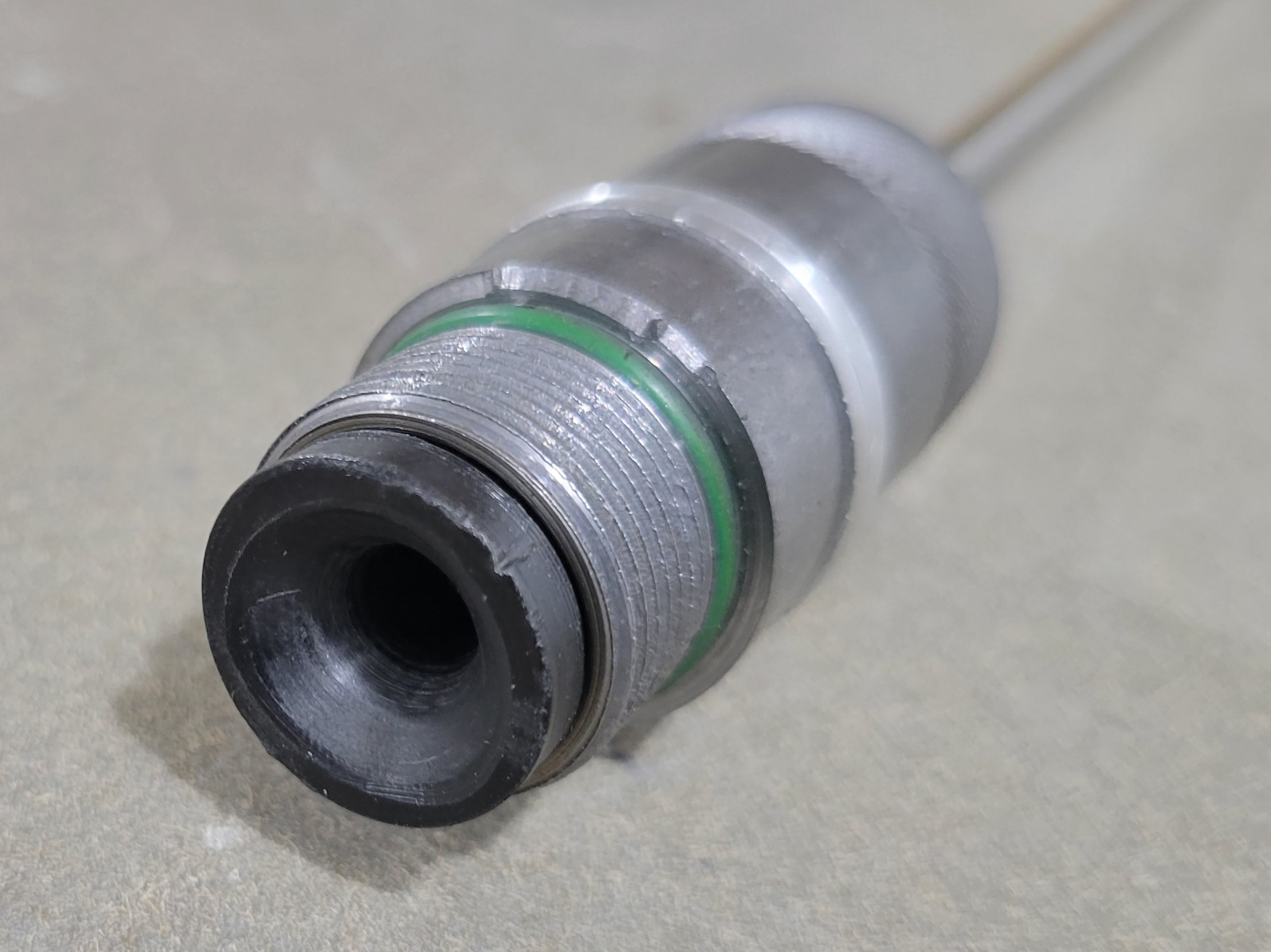

An interesting question and I thought worth investigating, so I made the following modifications to the Mini Hybrid II:
Blunt endcap insert:
Insert bore tapered:
I fired two shots each with both endcap variations, for each shot I used a 63cm long 0.177" barrel, 0.35 gram BBs, one layer of photo paper burst disk and a 19x mix with butane.
Velocity results:
Blunt - 1128 fps, 1143 fps
Tapered - 1146 fps, 1148 fps
There is no real difference between the results, the tapered average is slightly higher but not remarkably so, and technically speaking the chamber volume is slightly larger in the second case.
I'm also amazed by how similar the last two results are.

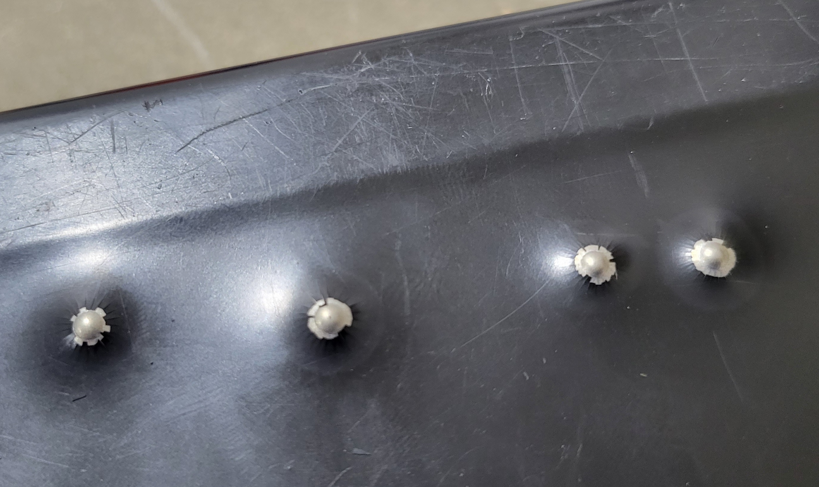

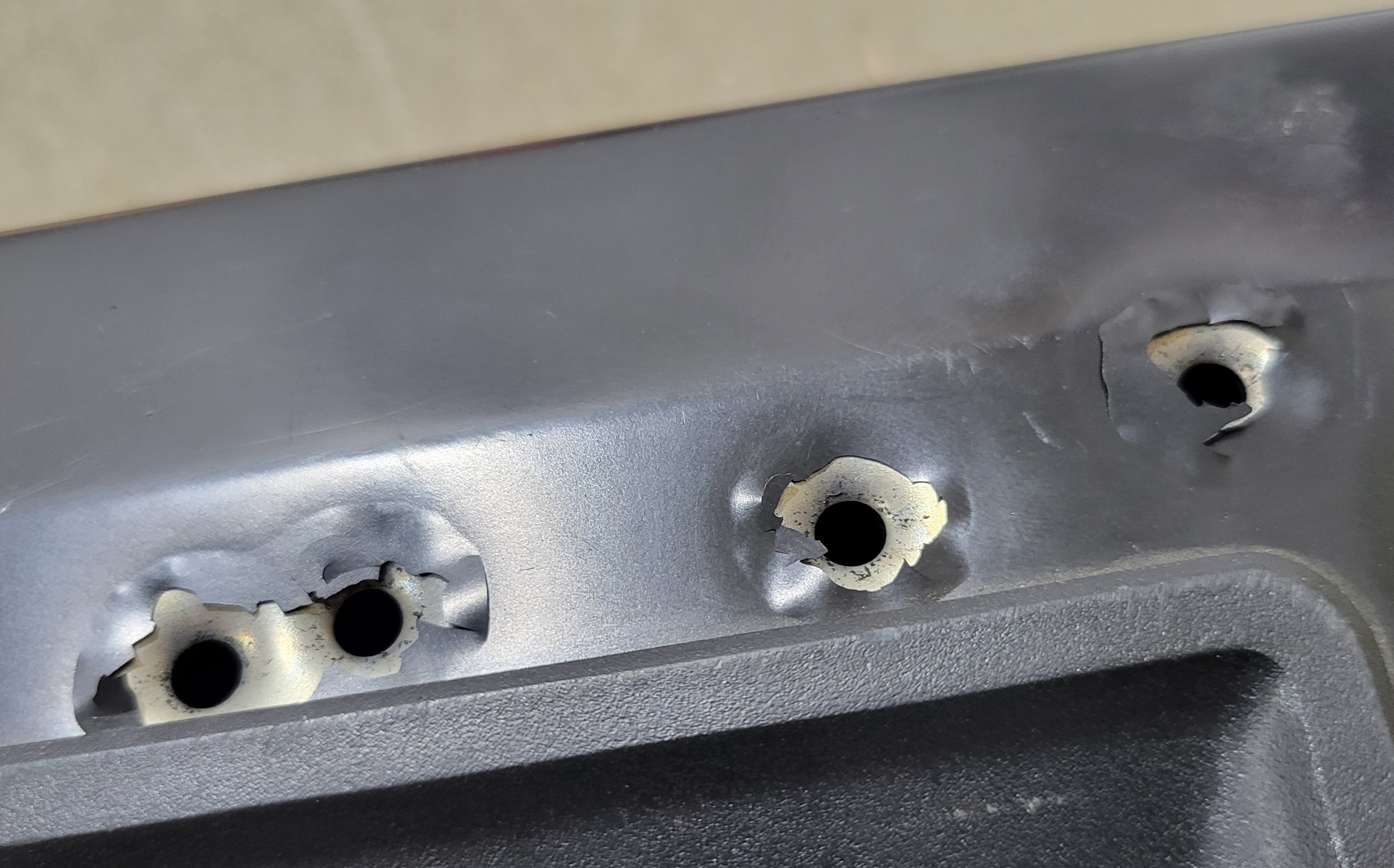

In order to corroborate the chrono results I also fired through a steel security box. In each case the shot cleanly penetrated one side and dented the other, in a very consistent manner.
Entry holes:
Exit holes:
In conclusion, the shape of the transition does not seem to be a significant variable in practice.
Entry holes:
Exit holes:
With say a 30 inch long barrel and 15x mix one can envisage sending a half inch round ball downrange at just over the speed of sound

My chamber walls are around .23" thick, so I should be able to run mixes considerably higher than 15 and remain in a safety margin. (Mathwise anyway)

Interesting tests. I always wondered what would be better... Now I know. The small differences in favor of the conical cap are only due to the small increase in volume.jackssmirkingrevenge wrote: Thu Nov 23, 2023 10:28 pm An interesting question and I thought worth investigating, so I made the following modifications to the Mini Hybrid II:
Velocity results:
Entry holes:
Exit holes:
