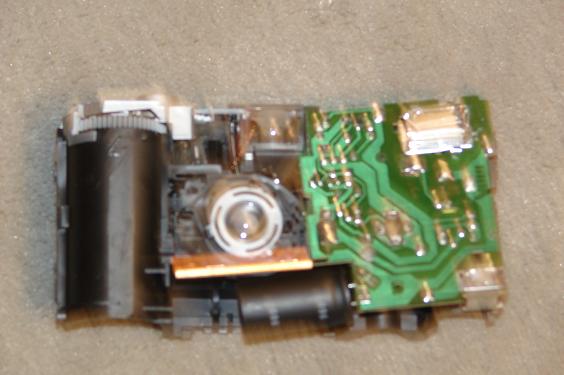

I'm trying to get a new ignitor, because my current one...broke. I'm going to use the camera flash method. I have a good idea of what to do, but just in case, could someone show me some pictures or a diagram of how much I could/should take off?

Will I need an ignition coil to make a spark?
EDIT: I touched the circut board with my pliers and the flash went off

Where/how could I find/make an ignition coil?
Also, will I need the AA battery, or does my capacitator supply all the power?

So, can the capacitator be fully discharged before I work with it, or should I just not touch the circuts? I wonder is wearing gloves would help insulate.
Erm.... its generally not nice to get a shock off the capacitor.
Get a screwdriver or something and touch both wires coming out of the capacitor. If nothing happens fine, its already discharged otherwise you'll get a fat spark flash from where the screwdriver is contacting the wires.
Either way its then safe to touch.
Just don't make a habit of touching capacitor wires with your fingers to see if they're charged
You need to keep the battery, the cap only stores a charge from the battery.
Cut one of the leads going to the ends of the flash tube, and connect input and ground of the ignition coil in between. Connect the spark gap between output and ground of the ignition coil.
Keep the original charging button or connect a switch to the terminals. Connect the trigger switch to the contacts going to the shutter (usually two thin metal blades that sit close together).
When the trigger switch is pushed the flash will fire, dumping the charge acros the ignition coil, which will produce a high voltage spark for ignition.

Yeah I think it's already discharged. I've shocked myself twice, and I tried to pick it up with my pliers, and the flash went off it my face.
