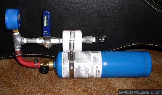

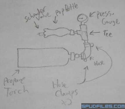

This is the fabled "Ghetto Propane Meter!" Okay, so it's not too fabled, but it is recent project. The purpose of this meter was to make a cheap yet accurate fuel meter. I was going to make the meter a little differently, with a small water bottle for the meter section. It was basically this:
<img src="http://www.spudfiles.com/official_pics/ghettosketch.jpg">
Preliminary Sketch

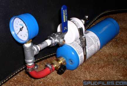

After much consideration, I scraped the completely "Ghetto" idea and chose to go a more practical route. Much to my dismay a 1/4 inch ball valve was added to the assembly as were a few other upgrades. The final product was inexpensive, yet somewhat sophisticated.
<img src="http://www.spudfiles.com/official_pics/ghettofuel.jpg">
<img src="http://www.spudfiles.com/official_pics/ghettofuel1.jpg">
The meter eliminates expensive fittings such as brass hose barbs used in my other propane meter. It also uses one valve instead of two. In order to reduce overall length 1.5" SCH 40 PVC was used in place of a smaller metal meter pipe. The meter pipe, when at this size was supposed to be slightly under 1". The 2 end caps together were about 2" long, so I had to fill about half of the section with Durham's Water Putty. I am quite pleased with this meter, and since the POSmini spud gun was a failure, I will be revamping the meter pipe to a longer length for a different gun.
Inexpensive doesn't always mean cheap! Luckily I do have a discount at work, and the ball valve and pressure gauge was salvaged from an old project. All prices are retail, but with good scrounging abilities you should be able to pick up some of this stuff a lot cheaper.
