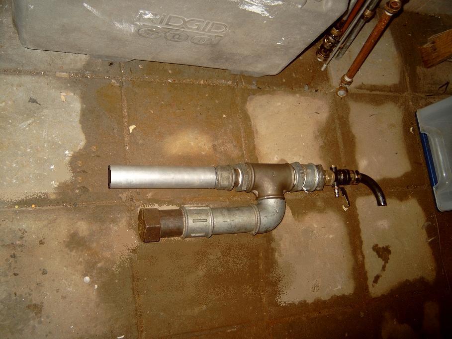

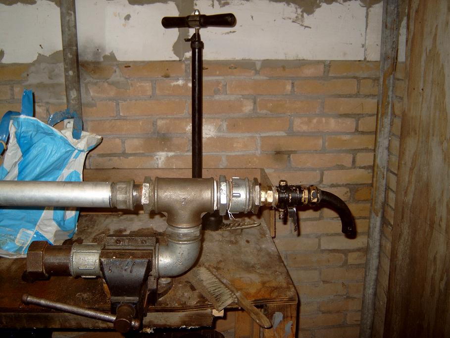

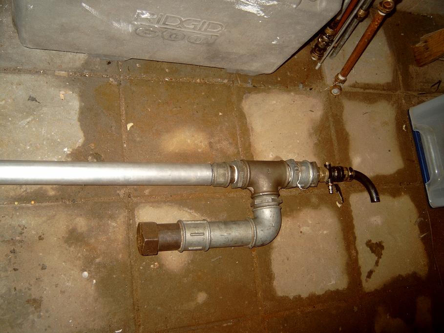

Well, here's a preview for you guys!
Cannon name: OVERKILL
built by Brian the brain
Type: Pneumatic
Material: Steel
Barrel: 1.5 "( approx) aluminium.
Valve: Homemade high performance piston valve
Exhaust: currently, the old sawed-off's ballvalve set-up
Max pressure: 30 bar
Powered by : customised high pressure handpump ( soon to get a shockpump added)
Ammo: BB-buckshot, spuds, cast lead slug ( maybe later...)
I didn't want to keep this one from you guys, even if it's not completely finished.THe ballvalve exhaust is forked up from over-tinkering, so it leaks.I'll change it to a 1.25"one and fill from the (new) bent handle.
The barrel and chamber will be closer together, once I install the new elbow, wich I already have.It's a 1.5 elbo with 2"threads on one side, wich threads all the way into the Tee.
The barrel will be chopped as soon as I finish the rest.
It will be Brians Overkill Sawed-off Shotgun, B.O.S.S. or Overkill for short
Oh..at 9 bar it's about as load as it predecessor at 23...

I hope I'll have time to show it off with a new paintjob ( flat black) and with the new fittings..

30bar and a 1.5" lead slug is going to have a hell of a recoil. Not to mention the force at the other end.

The handle will become slightly bigger.And I agree it's not gonna win a beauty contest....I was aiming for something else...like most impressive handheld.
And once I change the exhaust to a non leaky one..it will shoot "harder"..
It has about three times the push of the old sawed-off...remember what it did to steel cans and 2 layers of plywood in the same shot???
Take that and multipy by 3
