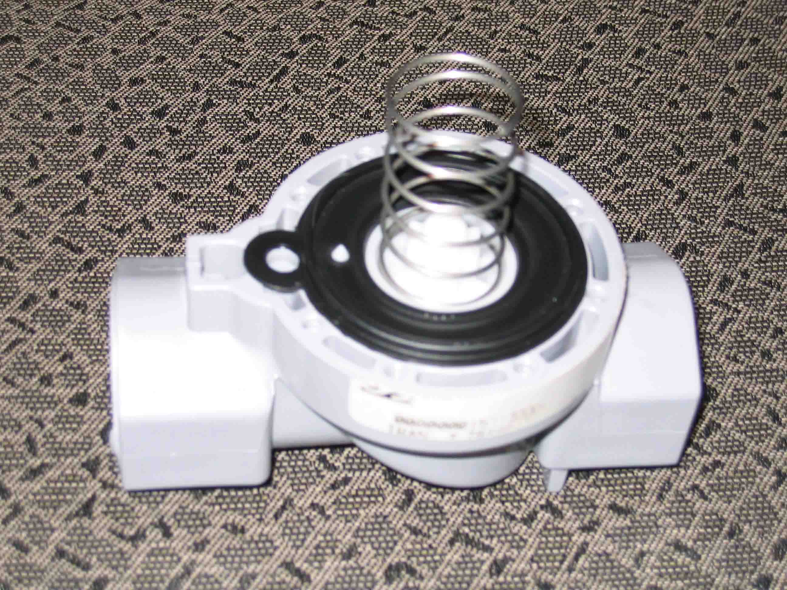

*Edit* Thanks for all of the help, but now of course I have another problem at hand... I made myself a very small pressure chamber for my sprinkler valve so I could test certain things. I pumped up the chamber with a bike pump, what else, and there were no leaks on it itself. Unfortunately, it was leaking pretty bad from the output of the valve, and this is before I modded it, I simply put it back together and tested it. Any ideas why it might be leaking?
*Edit* Another one, sorry. I just modded my sprinkler valve, (looks great btw), but my valve is leaking very very badly. I don't think it has anything to do with the mod... I can't see how that would affect it. When you try to add pressure to the chamber, it goes up to like 30psi and then just blows out the other side of the valve. I cracked it open and realized that there is a spring which holds down the phram... in it's default position, the phram isn't far down enough to stop air. Holding it down by hand, I can make it not leak at like 80psi. How can I fix this problem? :?:
Pic of the inside workings

I hade a different valve, but the same problem. take it apart and you will see ( should see anyway) a small piece of plastic that is maybe 1/4'' tall and 1/4'' wide. It just sits in the diaphram, take it out and it should work. what it does is it plugs up the equilization port.
pyr0
Posts: 11
Joined: Tue Mar 27, 2007 3:05 pm
Location: Massachusetts
hi wrote:I hade a different valve, but the same problem. take it apart and you will see ( should see anyway) a small piece of plastic that is maybe 1/4'' tall and 1/4'' wide. It just sits in the diaphram, take it out and it should work. what it does is it plugs up the equilization port.
Unfortunatly, the spring that holds down the phram sits on this pice of plastic, so yes it is there, but I don't think I can take it out and still have it work...

I had the same problem but I fixed it. When you take it apart there's a pipe that is in the center that the diaphragm sits on. K now on the diaphragm there is a plastic ring around the rubber that holds the rubber in place. So when the diaphragm was down, it was sitting on the ring of plastic instead of the rubber. This seems like the stupidest error ever for the quality control people who check them. It seems so stupid that maybe it was somehow my error but I fixed it...
all I had to do was file down the outside egde of the pipe inside and then it sealed against the rubber not the plastic.
btw. This was on a orbit watermaster 1" without a guide rod.

Unfortunatly, I do have the arrows pointing in the right direction. Could anyone elaborate on how to fix it like keep_it_real explained? I just don't want to mess up something that cost me $22. Thanks...
*edit* and it is actually a one inch sprinkler valve from orbit, so hopefully it can be fixed how keep_it_real explained... (there is a couple pics of it on top)

Update! I tweaked a few things in the valve and now it isn't leaking out of the front! :P Now it is leaking out of a different hole, but that can easily be epoxied over... can't do it now, cuz it's late, and I won't be able to do it until maybe tommorow night or sat. :( but when it does work I'll update this page so incase anyone else has the same problem they won't be screwed...
