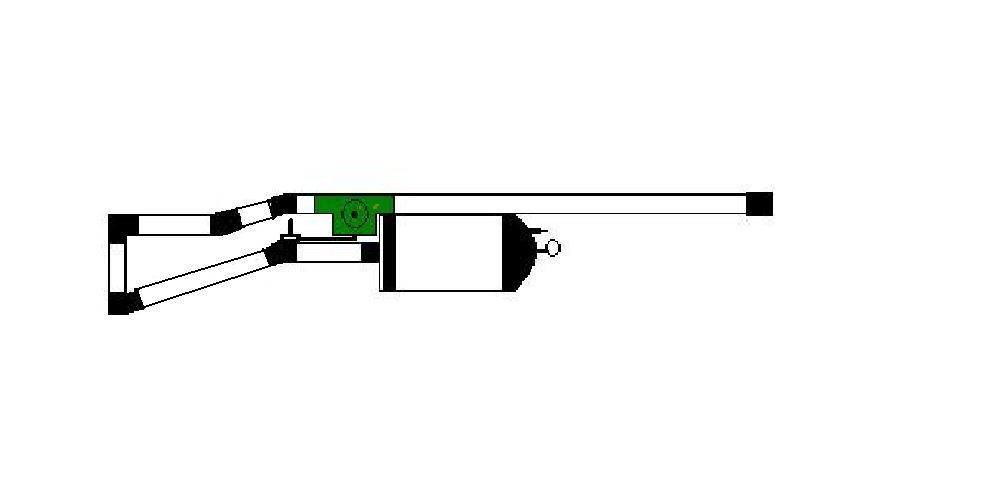

This is the FINAL design for the cannon/rifle I'm building this weekend. Instead of the old design, the chamber is now 3 in. X 12 in. At 150 PSI the GGDT says I can get 106 foot pounds and 550 fps with a 50 gram projectile. The valve is a modified sprinkler with a 1/4 in. ball valve actuator. The barrel is 30 in. long and is shc. 40 3/4 in. PVC. It is now also a muzzle loader due to its raw power.
- This is the old...
- riflesz.JPG (24.46 KiB) Viewed 3233 times

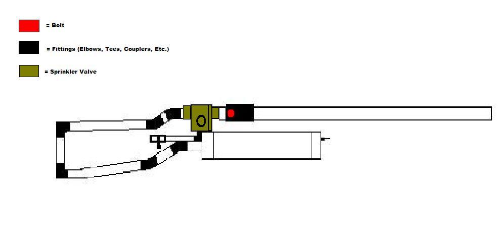

- This is the new...
Notice the new stock design and the safety valve - rifle model.JPG (17.45 KiB) Viewed 3233 times

There will be some dead space in that design. How bout you bridge the upper and lower parts of the stock and plug the rest.
- spudthug
- Corporal 5
- Posts: 936
- Joined: Mon Feb 26, 2007 9:02 pm
- Location: johnsonburg, Pa USA
that dead space wont matter because the valve is at the barrel...if the valve was at the chamber isnt that dead space??? (i know i am probly wrong but thats always what i thought) yell at me if u want but thats what i thought...maybe (most likely) im wrong...correct me
- Acdcmonkey1991
- Posts: 386
- Joined: Fri Mar 30, 2007 3:33 pm
- Location: Florida
I'm probably going to cut a custom piece of wood to put in between the sock and then glue it in between.
No, you're right.
Dead space is empty space that has to be pressurised by the released gas before it reaches the projectile.
There shouldn't be a problem with having the stock pressurised.
Flow restriction might be a factor, it would be more economical to take the shortest route, such as from the chamber, 2 x 90° elbows, then to the valve, and attach a stock on the back, like so........
or similar.
good luck.
skinner
or similar.
good luck.
skinner
PVC Arsenal 17
- Staff Sergeant 3
- Posts: 1762
- Location: United States
spudthug wrote:that dead space wont matter because the valve is at the barrel...if the valve was at the chamber isnt that dead space??? (i know i am probly wrong but thats always what i thought) yell at me if u want but thats what i thought...maybe (most likely) im wrong...correct me
You're right. I'm not all there sometimes.
- Acdcmonkey1991
- Posts: 386
- Location: Florida
The stock is actually part of the tank.
