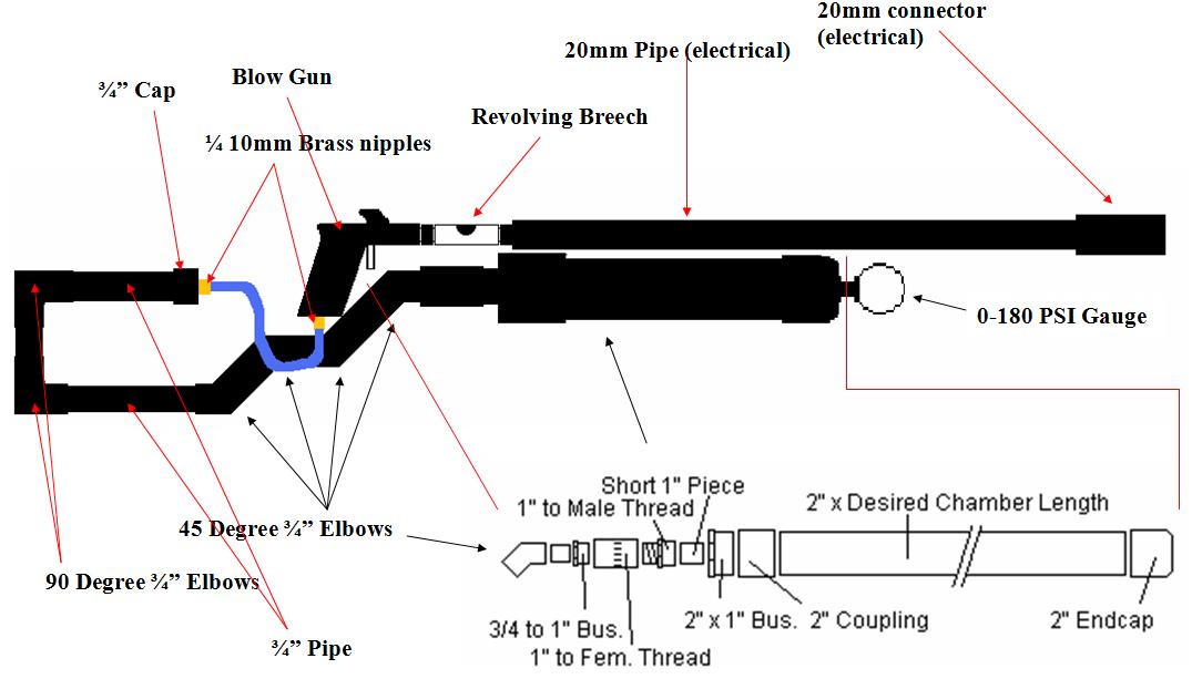

Hey guys, ive just came up with this design, mixing all designs ive made, and added some other bits and pieces to it, just wondering before i go out and make it, is there anything wrong with the design, and posibly the tank might last longer then 1 shot, as a blowgun close fairly quickly, the picture below is pretty self explanitry, if you have any questions please ask. and i forgot too add, the bb barrel is cased in 20mm, like i mean the 20mm goes over the barrel.
i encourage any ideas or suggestions you might have, constructive critisism, thanks in advance
One shot, BB Sniper.

might is suggest a few holes towards the muzzle end of the barrel so that air will bleed into the 20mm shroud and yo´'ll have an integral silencer
no valve??? whats going on man? what are ya gonna use this for?
you will definitely get more than one shot with a blowgun
a blowgun is nowhere near sufficient for a "sniper" type gun. you will probably be looking at a max range of 10 meters if ya lucky.
the gun is nicely laid out for its shape and size, but you should capitalize and back it up with some power. a sprinkler or even better a piston valve.
soz to "dis" your design but i think you have enough the knowledge required to incorporate a bit of power into this thing.

I doubt performance will be so dismal if he can "shock" the blowgun trigger - using a 6mm barrel 36 inches long, using a blowgun as a valve attached to my compressor at 110 psi, I can put a 0.22 pellet through both sides of a soup-tin.you will definitely get more than one shot with a blowgun
ok well i have tried it at 260psi man and it is very poor.jackssmirkingrevenge wrote:I doubt performance will be so dismal if he can "shock" the blowgun trigger - using a 6mm barrel 36 inches long, using a blowgun as a valve attached to my compressor at 110 psi, I can put a 0.22 pellet through both sides of a soup-tin.you will definitely get more than one shot with a blowgun
but why not put a lil bit more effort in and do a piston, it would be awesome to have power and a rely good looking stock to go with it.
build a piston valve housed in a 1" tee (trus me it aint that hard) and go from there.
wont work. like chaos said blowguns aint made to allow a rapid outflow of gas. Thats why u use it WITH a sprinkler valve.
If you are dead set on one of these designs might i suggest using a fire extinguisher handle, rather than a blowgun. It has a higher rate of flow, but u might need to mess around with your design for it to look pleasing to the eye again.

Don't be quick to dismiss the blowgun.
Here's a few videos I just made for the naysayers, 110 psi, 6mm barrel 39 inches long, using a blowgun as a valve. Ammo is a 0.22 lead pellet.
and here's what I used:

may be for multiple shots you can set it up like
large tank-needle valve-tiny chammber-blowgun-barrel
the needle valve can bleed air into the tiny chammber, its not 100% air effiecnt, but if you want full efficency
large tank-ball valve-tiny chammber-blowgun-barrel
but then you have to turn the valve to refill each time

You might want to consider a small diaphram valve.
If you have an old dishwasher or laundry washer you can use the water supply valve for a small bore compressed air gun.
I used one of these a while back for a <a href="http://home.earthlink.net/~jimsluka/dia ... tml">"mini" cloud BBMG</a> firing 0.177 BBs using 36"x1/4" brakeline for barrel. (Note: The valve is actually 3/8" not the 3/4" the linked page says.)
ROF's of ~120 RPS (but it only holds about 100 BBs) and muzzle velocities of ~350 FPS.
In a single shot gun with a larger gas resevoir you might get much better muzzle velocities than I was getting with a BBMG.

You don't need high flow for a BB gun anyway, air can only escape through the barrel so fast.
that looks good to me, i think that the blowgun wont affect how fast it fires its a small bb and like hotwired said it can only go down the barrel so fast...

its fine just mod the blowgun and give it an extra long barrel
