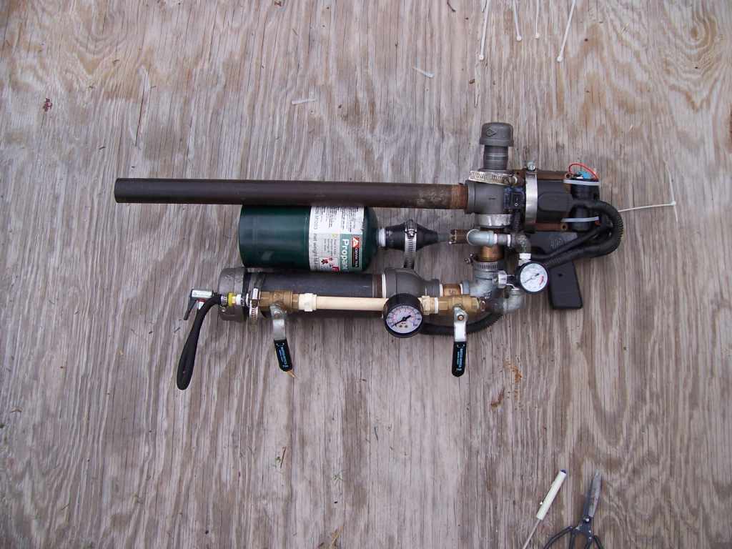

Fnord's Hybrid
This is a no-burstdisk hybrid which uses a piston and spring to retain pressure. Although it is in an experimental stage, it is still fully functional. Today I did dryfires at 1.5x and 2x mix to make sure everything was working properly.
I am currently making a new piston (the first one was quick and cheap and eventually blew an o-ring) and hope to get it working at 4x over the next few days.
Materials/construction
The chamber is made from 2" sch40 iron (I'm looking to upgrade this). The fittings are steel, iron and brass. It ended up being fairly heavy for its size (probably about 12-15lbs)
The piston is housed inside the brass pipe below the tee and is forced upwards untill it vents out the barrel (it shouldn't be that hard to visualize).
Ignition
The ignition uses a camera flash dumped into an ignition coil to produce around 30kv.
The flashboard and capacitor are contained in the handle and the battery is stored behind the ignition coil.
Fuel
The propane meter is detachable and adapts to anything that has a schrader valve.
This part was a royal pain to construct, as none of the stores around here sell propane tank adaptors. I had to cut apart a broken torch and epoxy the hell out of it to get a proper seal.
Features
Almost everything is detachable, including the barrel, chamber, meter, and spring cap. The cap can be removed and the spring tension ajusted to allow for higher chamber pressures before it vents.
Notes/misc
This is my first hybrid, and was constructed for under $40 USD. It was made mainly from stuff I scavanged.
It looks ghetto, but I feel that a paint job will only make it look worse. I wanted a gun that looked very MacGyver-ish, but still actually looked like a gun. The end result looks very close to the plans I drew up during class (Ill post them eventually).
I feel bad for not being able to give live-fire test results/videos, but my budget money arrived too late and I've only had 4 hours of sleep in the last 2 days due to the large amount of construction and troubleshooting Ive had to do.
Also, I think it needs a name. Feel free to post suggestions.

No way, that's sick. Is the piston in the top part of the Tee that holds the barrel?

Im really interested in the piston diagram, and the performance. what do you shoot
