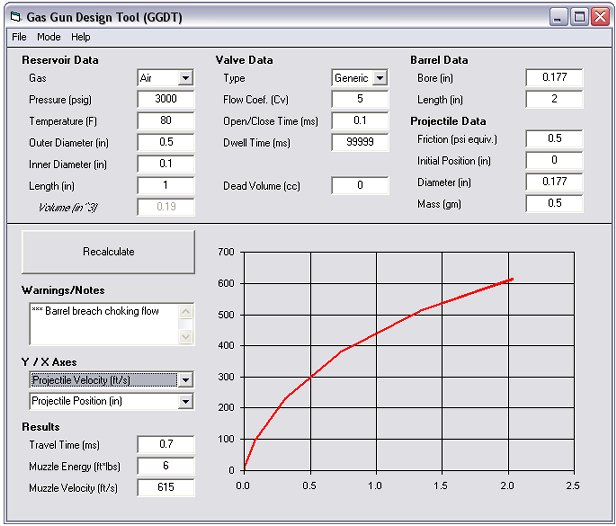

Well, IDK if its just me or what, but I can't get GGDT to run such small numbers successfully. It keep freaking out....

ammosmoke wrote:Well, IDK if its just me or what, but I can't get GGDT to run such small numbers successfully. It keep freaking out....
your projectile has a bigger diameter than the i-d of the barrel, and the reservoir data is wrong, somhow.

Yeah... a 0.0177 projectile won't shift anywhere in a 0.0166 barrel.
Also, don't you mean 0.177?

I'm being optimistic here, and only got half the speed of sound:
using an earlier version of GGDT for simplicity's sake.
