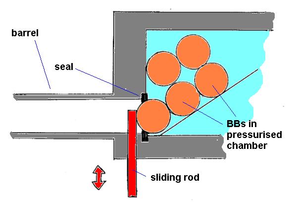

This is an idea I had a while back, which was to dispense with the valve altogether and use the projectile to seal the air chamber, locked in place until it was ready to fire. This would be to all intents and purposes the most effective "valve" happy red? :p I could think of.

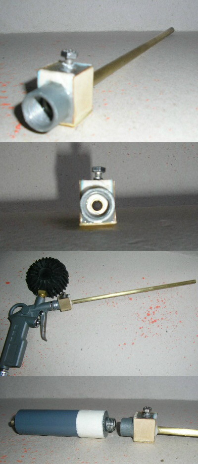

The prototype I actually made had a bolt as a projectile stopper and used 0.22 airgun pellets which gave a good seal on the barrel. The performance however wasn't any better than my mini-piston designs so I shelved the idea as not offering sufficient benefits to warrant the awkward method of operation.

concept drawing with a sliding lock
views of the actual prototype, from top to bottom:<br /><br />1)rear view of breech and barrel assembly<br />2)view down the barrel, you can make out the end of the bolt sticking out - note that it only has to enter the barrel a tiny amount to jam the projectile in place.<br />3)breech threaded to a blowgun for low pressure testing<br />4)High pressure chamber for 300 psi+ testing.
valveless strafer concept
prototype breech construction

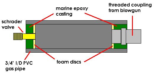

shud_b_rite wrote:I like your chamber. Where did you get it? Or how did you make it?
I made it myself, as per attached diagram.

chamber diagram
chamber diagram
