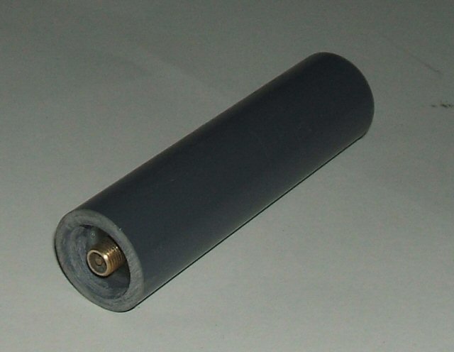

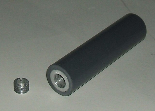

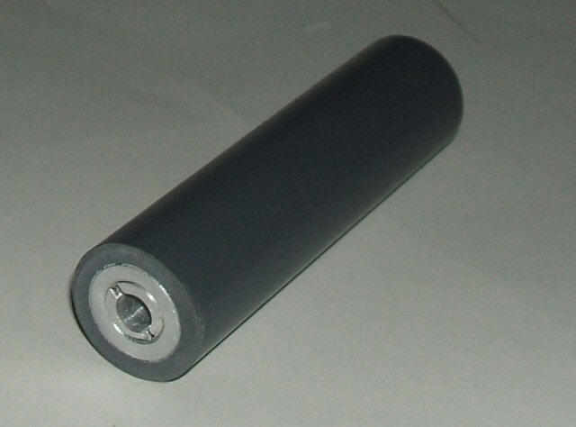

Well, my first "proper" cartridge is almost done, just needs to fully cure and some minor finishing. After that I'll test the feasibility of bursting the disk with a sharpened tube and the amound of force that would need, if that works then I think I have a project on my hands :)
cartridge front view, threaded section removed.  Note how I added a notch to enable it to be screwed in.
cartridge front view, threaded section attached
cartridge rear view
cartridge rear view

Hello Jsr, I was checking out your cartridge and it looks like a great concept but the thought i have is that there is a principal of firearm shell casings that when fired the shell expands/flex and temporarly glue to the chamber. but maybe with your application the spring force will counteract the pressure/recoil? i have an idea that since your shell won't flex maybe the front should have a thin short metal tip to create this effect.
what do you think about that?
Posts: 26220
Been thanked: 352 times
There is a principal of firearm shell casings that when fired the shell expands/flex and temporarly glue to the chamber
For what I'm working with, the opposite is true - the cartridge is pressurised before firing, and loses pressure on firing. I observed this effect with my preloaded cartridge prototype, where while the cartridge slid in easily into the breech when it was empty, once I pressurised it the effort to push it in was a lot greater.
In the case of firearms, the blowby of hot propellant gasses at high pressure is a problem because it causes rapid erosion of the metal. In our case however, a bit of air leaking past is largely insignificant, so I'm not too worried about to having a 100% seal as long as it works.

so some one acutlly machined that threaded part for you JSR? looks nice

iknowmy3tables wrote:so some one actually machined that threaded part for you JSR? looks nice
Friend of mine at the gun club, all for the princely sum of 10 Euros (that's a bit less than 16 of your finest dollars) :D

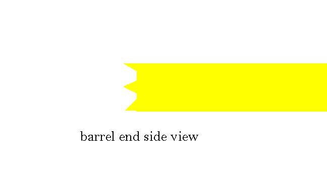

It doesn't have to work to pattent it right I am pretty sure that you can pattent it if it has a good/unique theory. just to say that it is yours.
For the barrel you could have little razor like points made from the barrel itself
