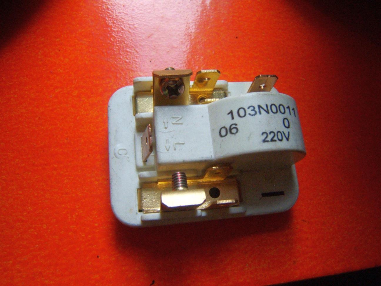

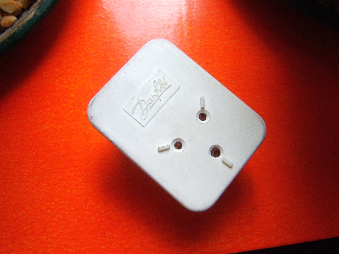

Here is something you might find useful... it's a starting relay with an inbuilt undercurrent protection
Most fridges already have one of these (or similar)... in case the fridge compressor doesn't work or has problems with starting up the part might be responsible for this (or simply the motor is broken)
I bought it at a shop selling spare parts for home appliances... it's exactly the same as the one I found on the internet (and provided a link to it somewhere on spudfiles)... the only problem was that they charged twice as much for it but it's kid of normal that stuff on the internet is cheaper...
if you can - buy one - even as a spare
you might find it useful one day because those already installed on compressors have tendency to break down (at least that's my experience)
besides they are quite cheap and they help to do wiring neatly and safely
you attach it directly to the 3pins on the compressor body... if you can't find them this means that there is one already attached to them so you 'll have to remove it (lol I know it's obvious.... and why do I write alongish post just to show two pics?!)
