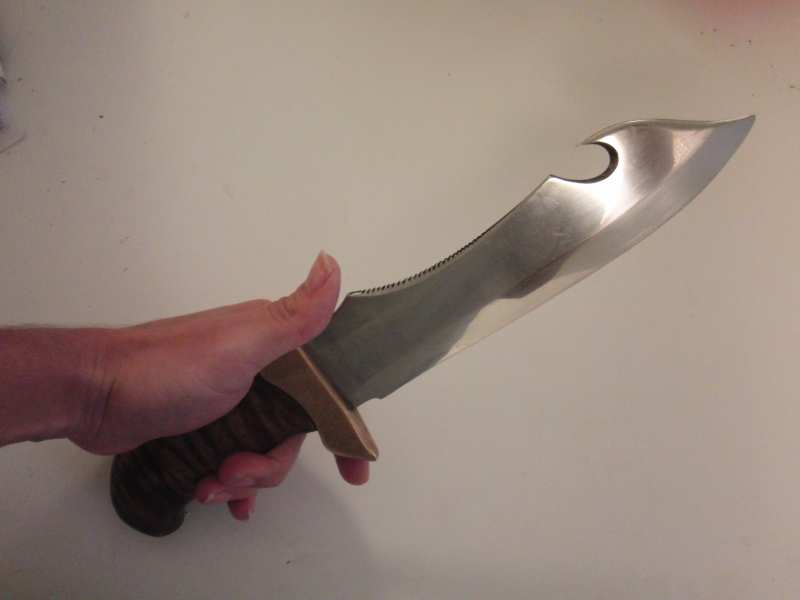

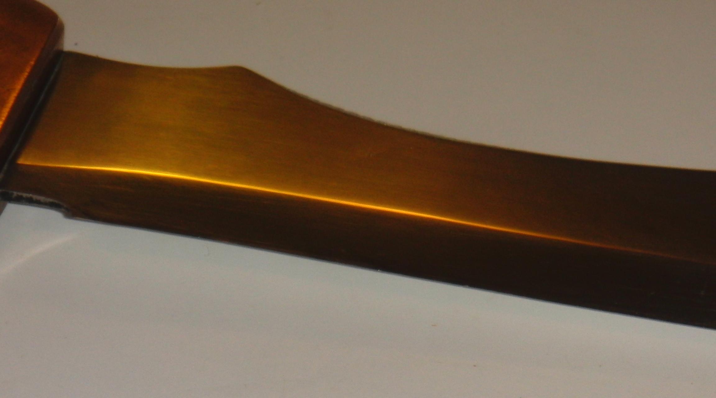

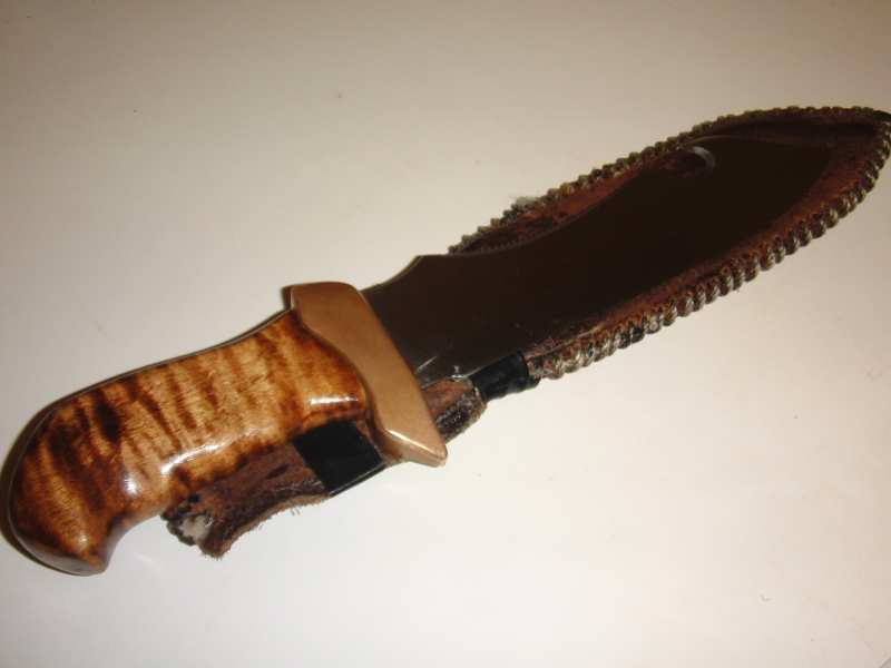

This is the knife I mentioned earlier in this thread. Since I know nobody wants to go back and look for the specs, here they are
12 1/2" overall length, blade 8"
Hardend 440C stainless(plate quenched, cryo-treated and double tempered at 350F, so it should be in the 58-60hrc range.
Brass finger guard, kinda dull atm. Soldered on with tix solder.
Partial tang that goes nearly to the bottom of the handle, cemented in with JBweld.
It was slightly dull after heavy use for a month(trees), but 10 minutes with a whetstone brought it back to razor-sharp.

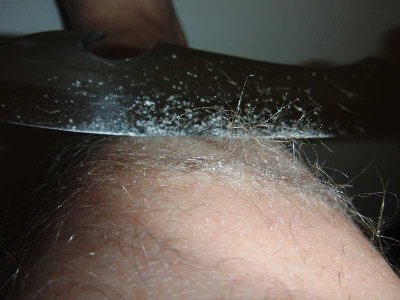

The blade is mirror polished with  1500grit sandpaper and polishing compound. Looks a bit scuffed up in the picture but in reality you can see your reflection clearly in it.

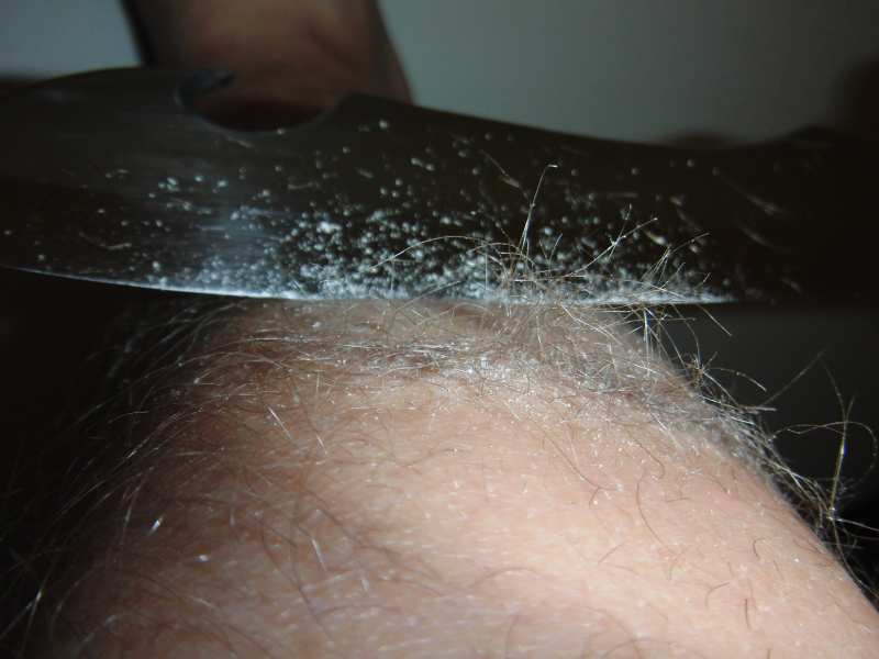

Angled with flash to show the stripes in the handle. The cool thing about this wood is the stripes change and dissappear depending on how you look at it. I'm pretty sure it's tiger maple.

gosh, that's sharp
gosh, that's sharp
Edit, close up of the blade edge. You can see two small nicks that are around 1/100th of an inch deep
