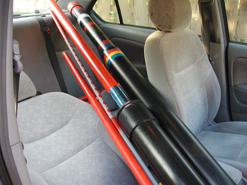

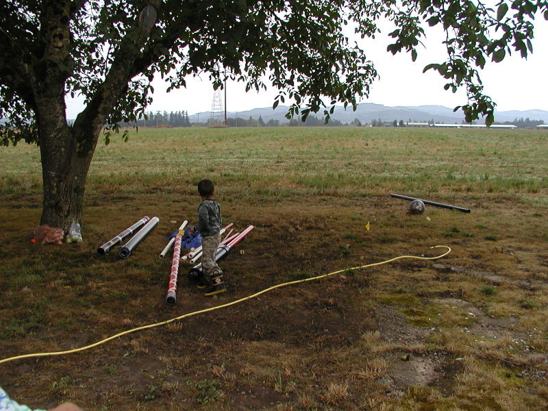

All packed up for next time

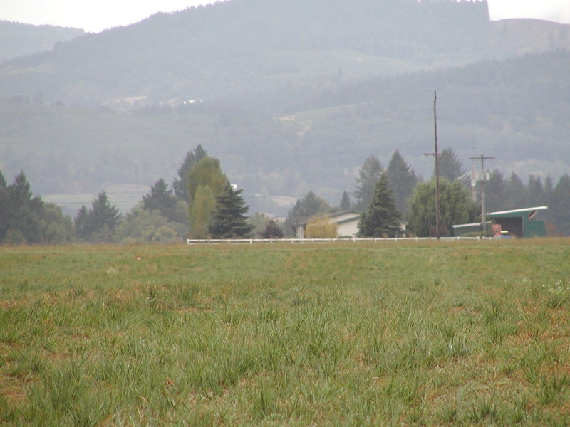

Telephoto view of a couple of the markers.  The yellow one blends in and is really hard to spot.  Can you find it?  The flag is 2 inches square. The red one on the left stands out.  It was marked with the arrow in the prior photo

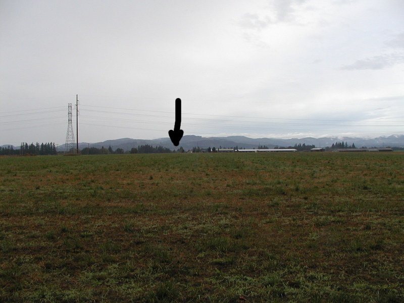

This is a view down range.  There are about 6 flags on wires marking the landings out in the field. The arrow points to the red marker in the next photo.  We did go over the powerlines.
The artillery is laid out ready for action under the walnut tree.  We connected to the farm compressor in the tool shed instead of my wimpy compressor.

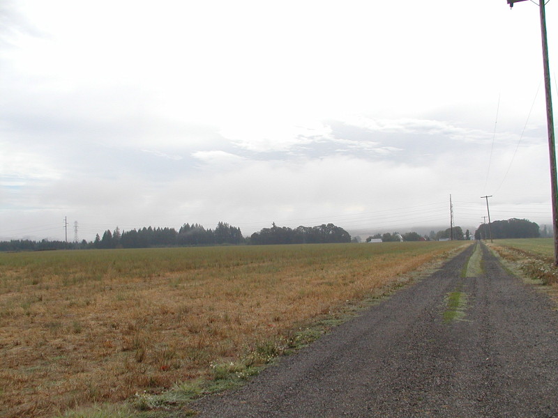

Entrance to the farm.  We launched from under the trees by the red barn.

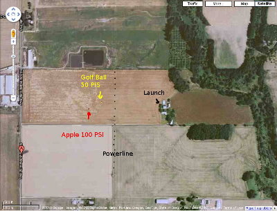

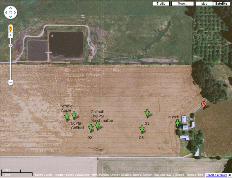

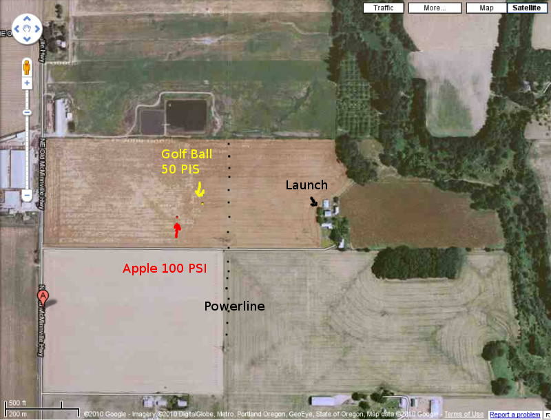

Until I get GPS coordinates laid out proper, this is a rough location of an apple at 100 PSI and a golf ball at 50 PSI. The red flag for the apple is easy to spot in the telephoto shot. Powerlines and launch tree are marked.

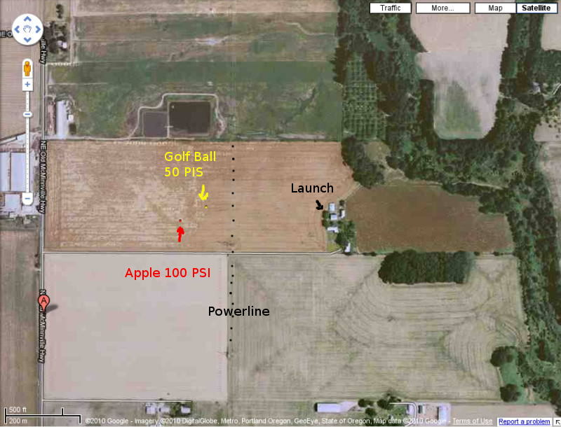

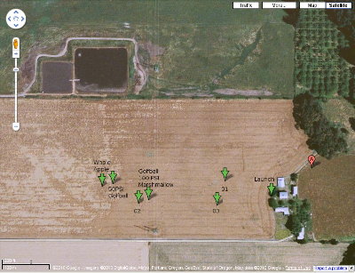

I took the time to post the GPS coordinates of each shot and take a screen cap, then with a photo editor I copied each marker onto one screen shot aligning the background of each edit for precise location. The composite photo is below.
The numbers are random spuds and apples from both the Marshmallow cannon and large cannon with the 2 inch barrel. The kids got turns shooting the marshmallow cannon at lower pressure. Not all shots were measured.
A whole apple was launched from the 3 inch barrel at 100 PSI to see if it would fly better uncut. It did and was the farthest shot of the day. No wadding was used and it was loose in the barrel.
A golf ball was launched from the 2 inch barrel with a paper towel at 50 PSI and one was launched from the marshmallow cannon at 100 PSI. That was the only two golf balls launched before we got rained out. I still need to find all distances in feet. I am checking my various GPS programs and settings to get this. So far, they convert to miles at 0.1 miles. :(

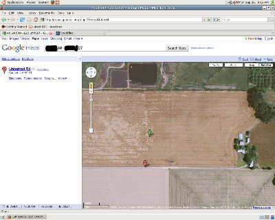

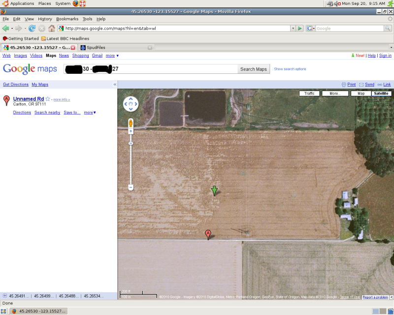

screen shot of entering the golf ball GPS coordinates to get a map marker.

Here is what I came up with using Google Earth.
dewey-1 wrote:Here is what I came up with using Google Earth.
356 yards for golfball at 50PSI. (.20 mile)
424 yards for apple at 100PSI. (.24 mile)
I'll PM you the numbers right from the GPS. The launch site is the next big tree to the south near the gap between the trees.

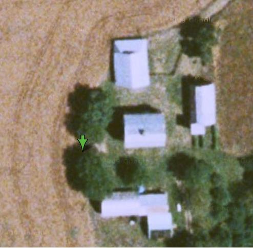

Launch site
Launch site
