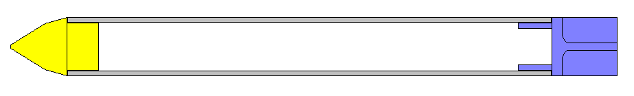

Personally I like the one that consists of just the cone and the tube - damn simple
I don't think we need another miniboy that's too valuable to lose - ammo has to be cheap
I concur on several of these points.
Going by this list, I doubt we would achieve a Image much better than 0.3 for a capped weighted tube.
On the other hand, if saboted with a simple spindle it can be built with very low frontal area and high sectional density which will convey a tremendous advantage over a conventional projectile.

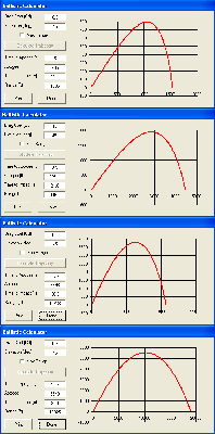

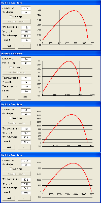

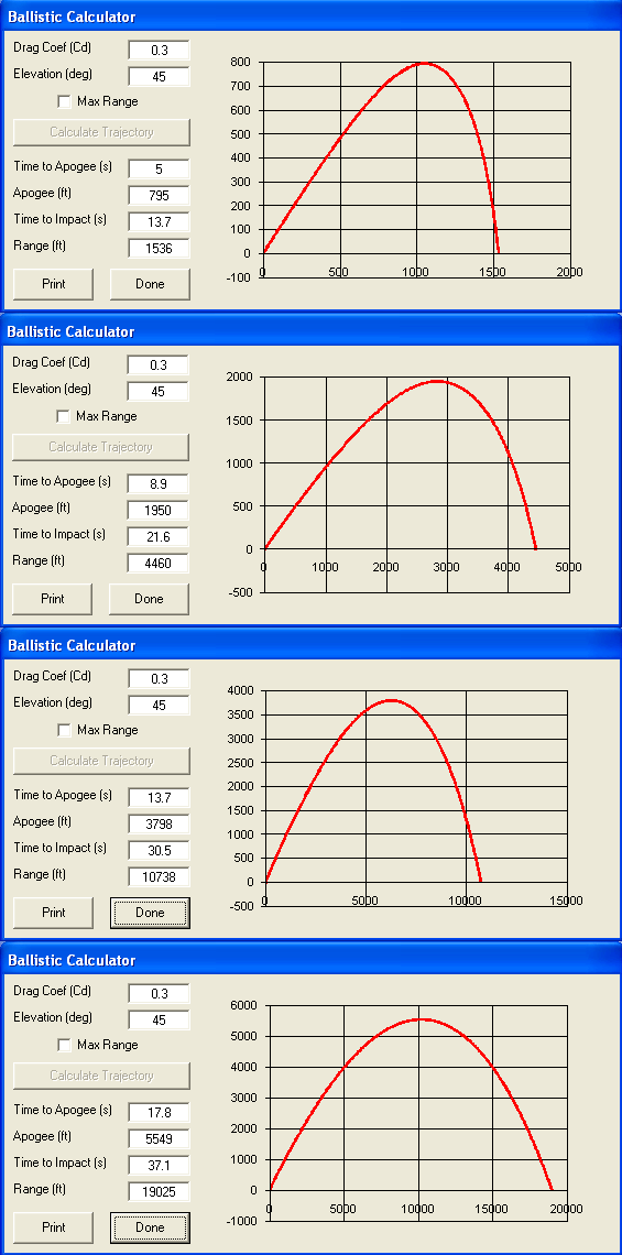

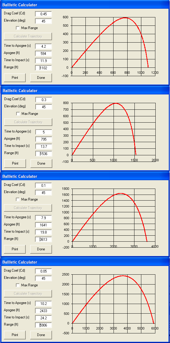

Attached some GGDT simulations using a 20 gram projectile in a 1 inch barrel fired at high subsonic velocity. In one series I varied the drag coefficient, in the other the projectile diameter (1 inch -> 0.5 inch -> 0.25 inch -> 0.125 inch), in all cases the velocity and weight was kept constant.

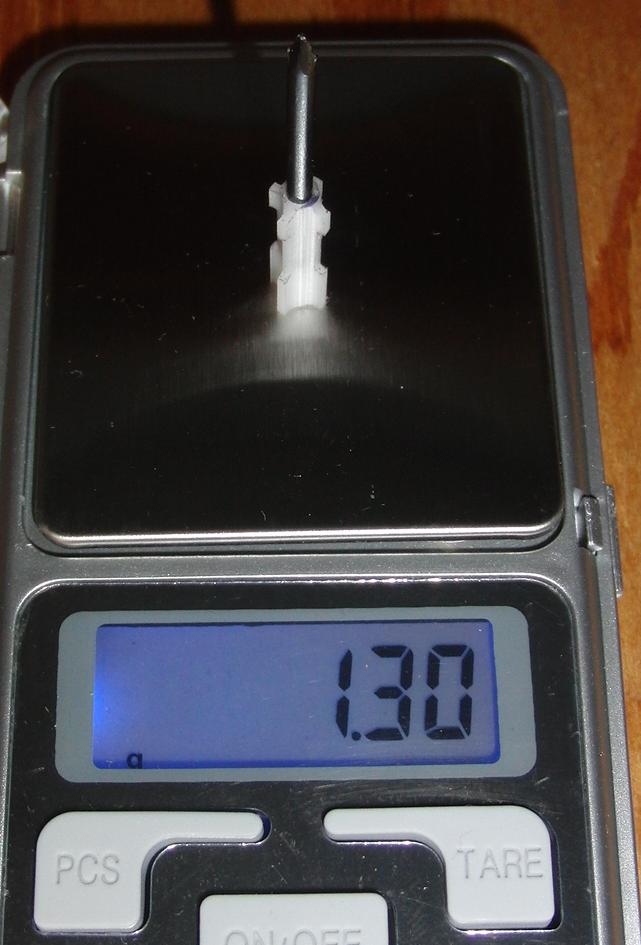

I might try a compromise using a delrin endcap with fins milled into it...

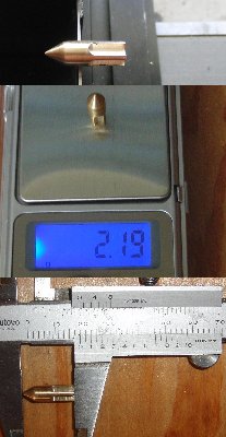

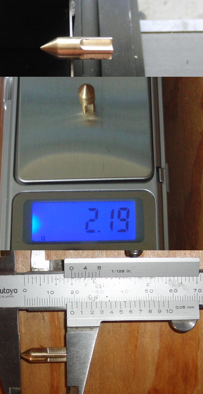

Also some more detail of the brass projectile.

Reducing projectile diameter
Reducing drag coefficient

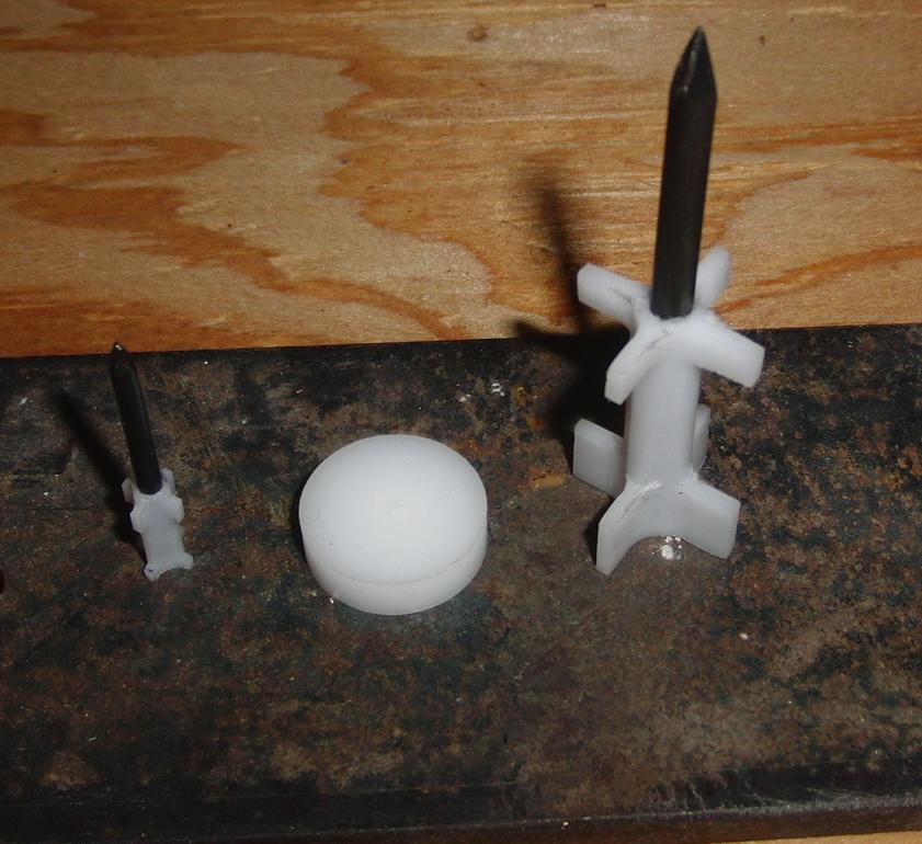

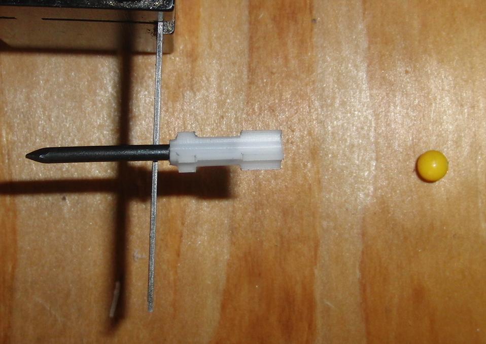

Because my head is throbbing and because I can, herewith the APFSDS projectile with fullbore fins I keep banging on about, in 6mm scale using a 2.5mm wall nail. That airsoft BB will made good cheap light wadding :D

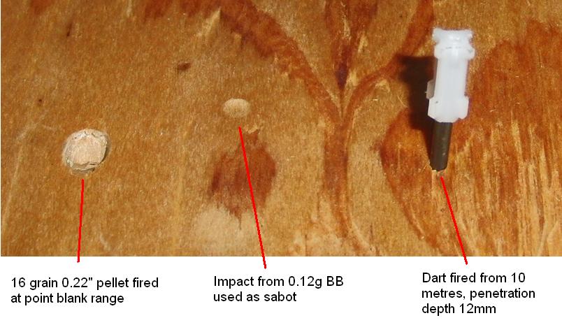

I had to trim the tail down because I went overboard with the milling but it made no effect on performance, flew superbly at 10 metres fired at 1/2" plywood. Compare the performance with a lead pellet from the same launcher at the same pressure fired at point blank range, the performance benefits of using saboted projectiles are plain to see.
what about the one you machined ?
POLAND_SPUD wrote:what about the one you machined ?
Hit the ply nose first at 10 metres, bounced off.

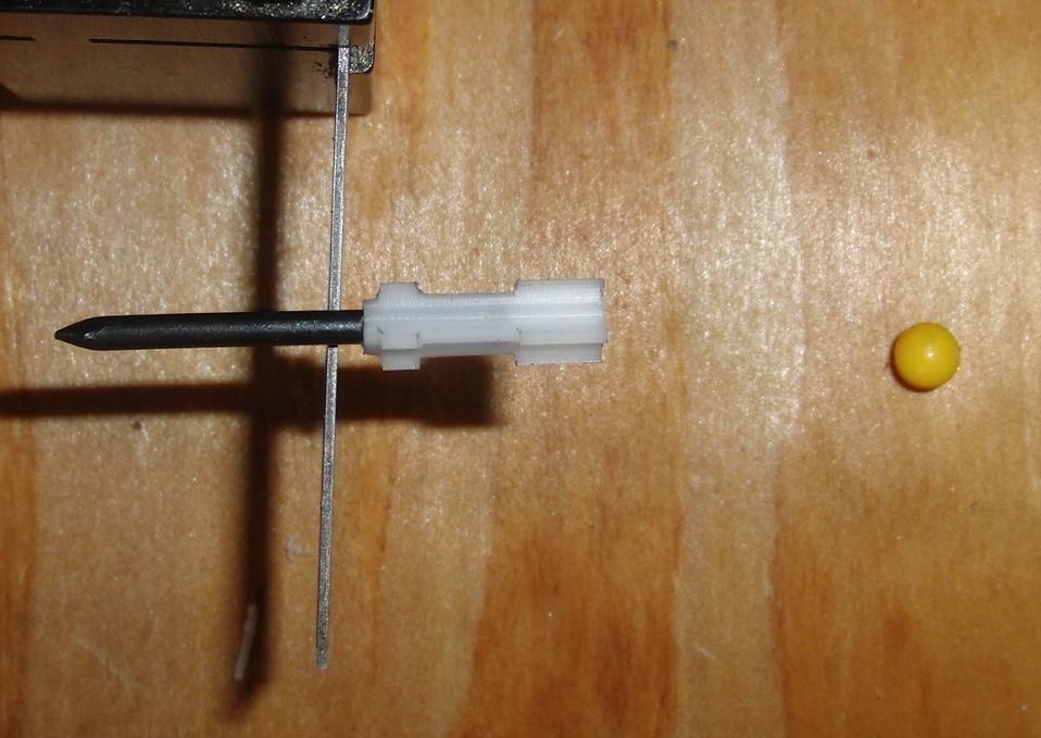

In the meantime, scaled up the fullbore fin design for a 3/4" barrel, herewith some high speed footage (210 and 420 frames per second) of low velocity testing, fired using lung power at cardboard sheet:
Here it is with the wadding disk alongside its little brother, standing on the 1/4" steel plate I intend to fire it at from my 3/4" hybrid. Excrement just got real :D

Very impressive at that size. Send me the dimensions on a picture for CAD model.
Lighten up the wadding puck on the fin side by cutting out a recess.
Cut a notch in rear fins to allow for the recessed area. Could be an angle cut rather than a notch to look better.
Chamfer/radius the leading and trailing edges of the fins will help.
You know my usual questions!

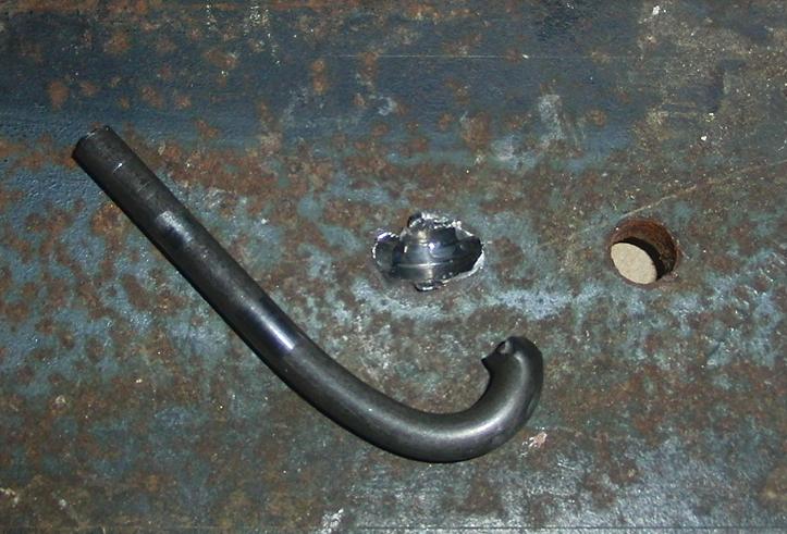

Any discussion on the matter is moot as I've already turned it into a shower of sparks :D could only find the severely deformed nail, heaven knows where the delrin parts are. I really should stop doing this stuff indoors! I'm starting to think this particular plate is especially hardened, it's tough stuff and I don't remember where I had picked it up from. Test was at 20x by the way :D
For what it's worth, CG was at the start of the delrin section and combined weight of projectile and wad was 9.05g.

Use Ramset Nails!!!!!
For steel and concrete.

Reminds me of that coin test we did.
The first one I tried was a nail vs a 2p coin.
Ended up looking like that with a small gouge in the coin.
2p coins are actually steel, the coins everyone else had been putting nails through were made of vastly softer metal :roll:
Use an aluminium sheet, should go through it like a nail through aluminium.
