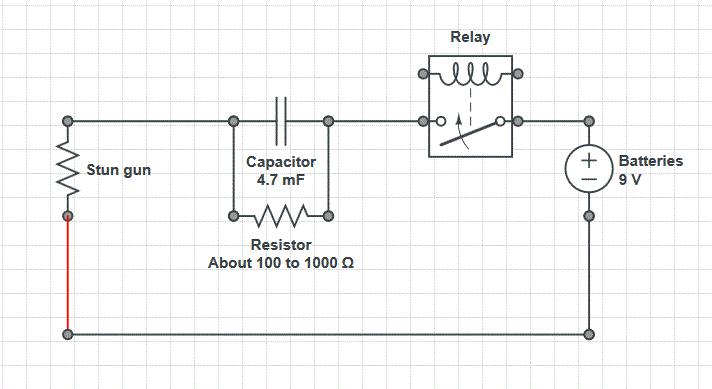

No, the capacitor goes in series with the stun gun, positive terminal to negative. You've got the resistor right though.
I reckon a 4700 micro farad cap should do the trick, they're pretty cheap, and you'll only need 16 volt caps. If it doesn't run for long enough, then chuck another cap in parallel. Would be worth buying a few, it's a handy size for power supplies too.

Could you draw the circuit? I´m a little confused :?

wyz2285 wrote:Could you draw the circuit? I´m a little confused :?
Certainly, I used http://www.CircuitLab.com for this, I just screencapped, couldn't be bothered signing up. It's also got a neat little simulator, which might be fun to play with
Enjoy
Enjoy

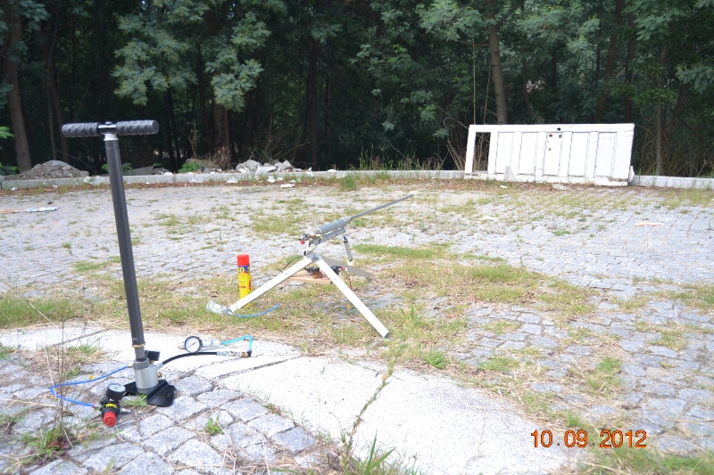

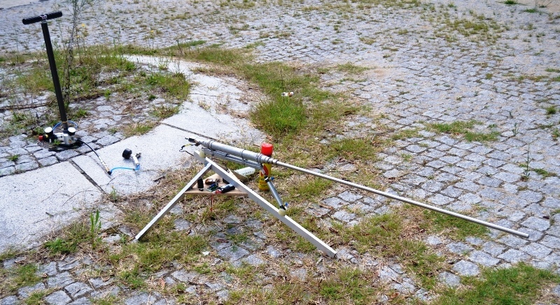

Didn't have time to fix the ignition shutoff system duo to my girlfriend but I thought I really should fire this beauty one last time this summer.

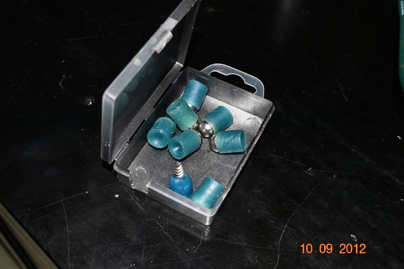

So I made 8 rounds with 10mm steel balls candle wax saboted to match the 12mm barrel bore. They turned out to be a really simple way for a perfect match between sub caliber ammo and barrel.

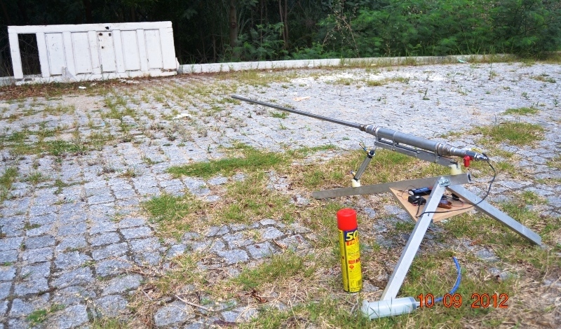

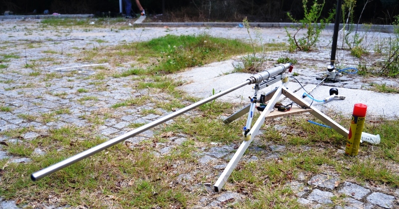

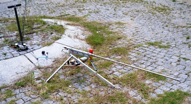

Went to shoot this one last time this summer holiday :(
Cut 13 burst discs, 13 deadly bullets...
Only 5 shoots was made, witch 4 of them are badly recorded... All because a stupid ignition problem, witch I mentioned here
This thing IS wonderful, but just too loud to use :? ... There is no neighbour nice enough to deal with all these BANGs.
More video to come, sorry they are not edited, so they are kind full of crap, but I+m out of time.

I was going to shoot it some where else but the ignition just needed to be repaired so I ended up shooting there :roll:
