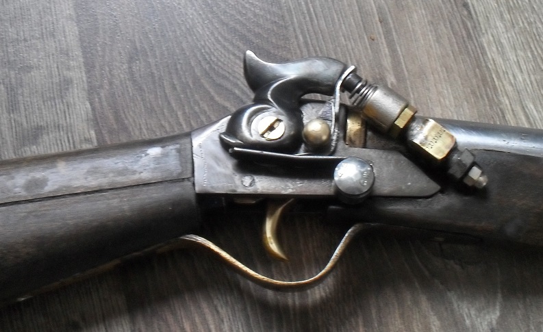

Fixed her...
paint is all danged up now but that is an easy fix.
At least she's back together without me having to replace any vital parts.
This means I can use the material I have for another one.
I've got most of the parts I'll need and I'm sure I can scavenge the rest.
I got a new welder last weekend...so I have the option to make one like it...but better..
Probably one that is able to use higher pressure, like unregged CO2...and I'm really tempted to go for a bigger bore..
I've calculated that a 16mm ID will give me just below 1:1 chamber to barrel.
Should be more than enough at 900 psi..???
Maybe that 'll raise some interest at the gunrange.. :D
Pretty sure they won't be expecting a homemade airgun to rival what they got..
The hammer will hit a lever wich will push the hammervalve with more force, less travel.
I'll need the leverage to overcome the tremendous forces on the pilotvalve.

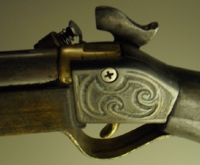

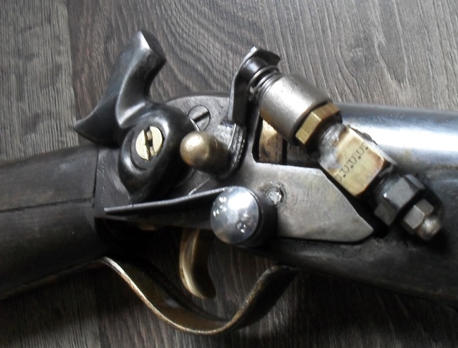

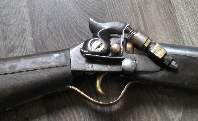

I case-hardened the hammer and lockplate...no need to worry about wear...and it looks killer!!!
The barrel assembly has been shortened by about 1.5 inch...I needed to start fresh on the pilothole as I couldn't fix it leaking...
Certainly makes it look even more like a blunderbuss...
I also replaced the hammervalve by a counterbalanced one...giving it the potential to pilot at much higher pressures :D
Next on my list is...some more case-hardened parts....and a 1/2"barrel to replace the 8mm one.. :lol:
The wood needs to be refinished...I had to open her up completely...So the split in the buttstock is now visible..will fill that in..

Awesome work as always, ain't a counter balanced hammer valve a bit overkill :lol:
Netherlands
Posts: 3497

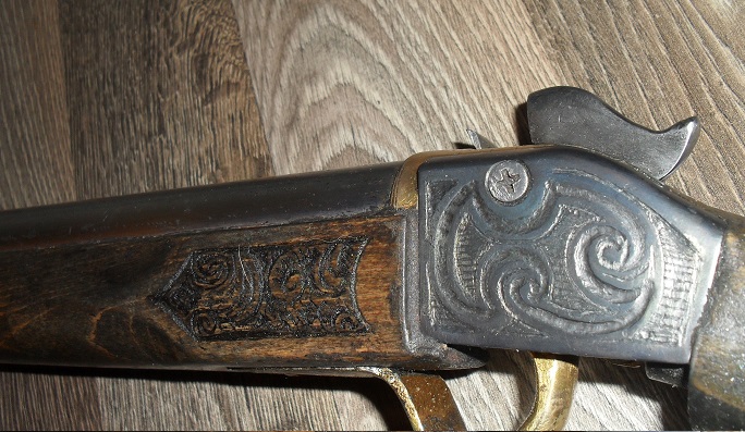

Better show you the other side then....and no...the CBHV just gives me a wider range of power... :D
Oh...I filled in the split...and did some more artwork...wich looks better without the flash...
