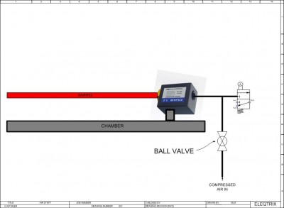

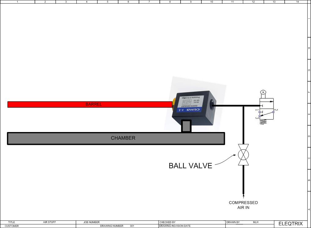

I think this layout will work if these are the parts you have
Or you could make a lever arrangement that holds the trigger closed (spring) and releases it when you pull the trigger, I might actually do that myself for the pistol project as I have a normally closed valve that would make a nice QEV trigger. :idea:

Hmm not sure i want a ball valve on there as well..but thanks F1 appreciate the help. :)

Yeh I wouldn't want any extra valves either, that's why I fill through the trigger valve, so it has to be normally open.

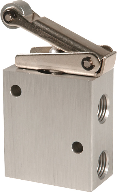

I got mine from McMaster Carr, but Princess Auto do a nice 3 port 3/2 :idea:
https://www.princessauto.com/en/detail/ ... -p8192437e
Air2theBrain
Posts: 222
Thats a nice one you have, very low working pressure rating i noticed?
