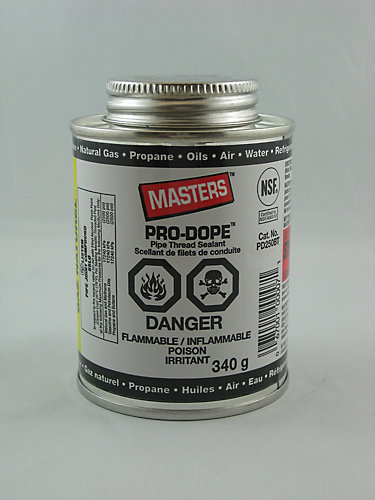

Do You guys use sealing washers between QEV and chamber/pilot/barrel? I have bad time with teflon tape. Hemps with sealing paste works sort of but I dont think that is good idea to use them with pressures like 10-15 bar.
Re: Short question topic
Posted: Sat Apr 28, 2018 5:56 pm
by farcticox1
I use this
Rated at 10,000psi :shock:
