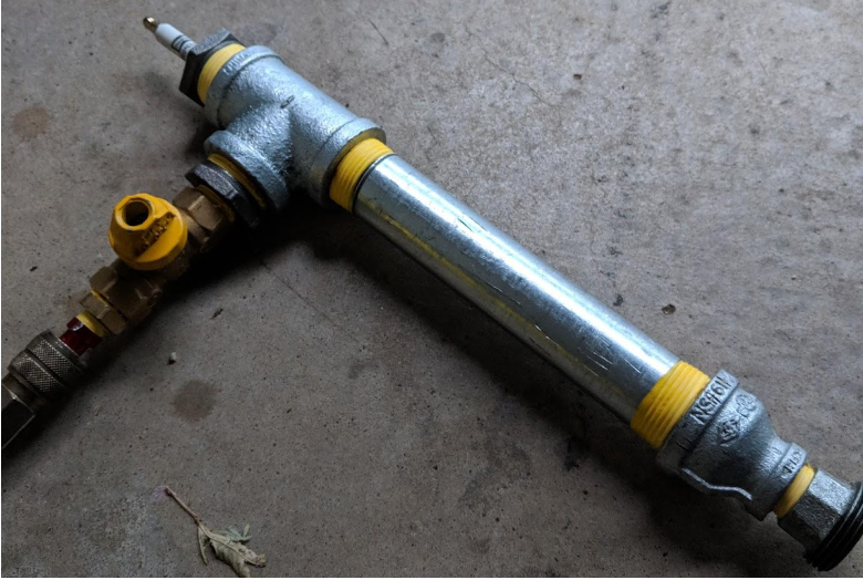

I've been working on my first hybrid, and I'm getting some serious grief with the ignition.
I epoxied a spark plug into a pipe reducer fitting and threaded that on to the combustion chamber and I got it to spark with a regular barbecue igniter (one of the ones that uses batteries, not a piezo). But I still can't get ignition. Should I just give in and order a taser? Or is it more likely a mix problem?

Also, has anyone experimented with using electric matches (the ones they use for model rockets) on hybrids? I feel like it would give a much more surefire chance of ignition and it's easier to make.
How are you filling your fuel/air mix?

jackssmirkingrevenge wrote:How are you filling your fuel/air mix?
syringe fueling :D Its worked well for me in the past but I can't even get a 1x to ignite on this.

Either you aren't actually getting a spark or your mix is wrong. Pretty much any electrical spark should ignite a correct mixture. (Though at high compression ratio's it'll take either a higher voltage or a narrower gap to get a spark.)
