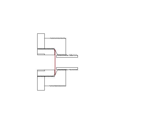

I was thinking about how to avoid having to get the burst disk holder custom machined, and came up with this. Still requires some work, but could be done yourself.
It consists of a hex bushing, a socket set screw and a nipple. The left side of the bushing is drilled and tapped to fit the set screw. The set screw is drilled out to accept the barrel, with the socket acting as a guide for this. The nipple to hold the projectile is threaded into the right side.
The socket would have to be equal or larger than the barrel so that it could still be used to insert and remove the screw.
The available sizes of set screws may limit this too much, and I haven't used a tap before so I'm not sure how difficult that part would be, but there must be a way to modify existing parts to create something more compact than a union.

As an update to my burst disk holder idea above, I wasn't able to drill out a set screw. It was too hard, and dulled the bit right away.
The solution I found was to use flare fittings. But I think the angle may weaken the burst disk, so more layers or thicker material may be required.
