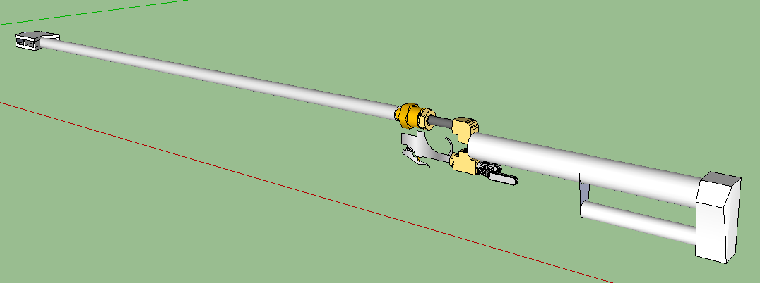

I'm not in a hurry, I just was on this thread and I though I'd try to model my gun. No rush, take your time. Thanks!

The way I was getting the scale down to one inch (from 12 inches) was select all, scale tool, I grabbed the corner and typed .3333. That brings the scale to 4 inches, then you repeat but instead of .333 I typed .25 and that brought the scale down to 1". Seemed to work for me, so I saved them.
Jeeeez that took longer than I expected. 3D is so hard to work with. :tongue3:
- valveless (2).png (34.26 KiB) Viewed 86847 times

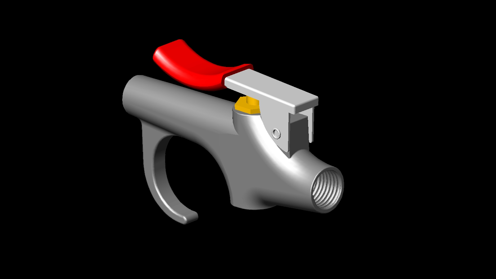

Hello, dewey-1!
Your sketchup models, like
http://sketchup.google.com/3dwarehouse/ ... revstart=0
has interesting style of 2-1-2-1.. visible lines on curved surfaces, which seems to me better than all lines "soft" and "smooth". Would you reveal please how do you do this?

The visible lines on a 3D model can vary depending on which type of renderering scheme is used. See chapter 3 section 5 Examples.
http://people.csail.mit.edu/fredo/Depic ... aphics.pdf
All my models were imported into Sketchup and the results are what you see.

Practice, practice and practice some more! I've been going through the training video's myself and it does take practice. The devil is in the details. Smoother line can happen by adjusting the degree of view. If you use the orbit tool and spin your model and watch the lines you can see them get jagged then smooth if that's what your referring to.bflmpsvz wrote:Would you reveal please how do you do this?
If your talking about mating surfaces of 2 components it matters where you grab on with the move tool. Using guide lines made by the measuring tool helps big time...
I am talking about the particular model. When I make a simple cylinder in Sketchup, if I see it perpendicularly to its axis, it's hard to say if I see cylinder, cube or even rectangle. But with lines collateral to axis, it is much better. I could let explode the whole model and make all lines visible, but usually there would be too much lines. Your model seems to me like good compromise.
But now I suppose this feature of our model was created in other software, and that there is no tool in Sketchup like "make visible every Nth line"...
Click "View", then check "Hidden Geometry" and you should get the lines you are asking for.

dewey-1 wrote:Click "View", then check "Hidden Geometry" and you should get the lines you are asking for.
Sure, but there are 5546 edges in your schrader-valve model. Setting manually entity info for each of them, it would be very ineffective...
