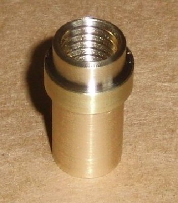

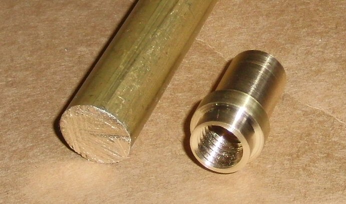

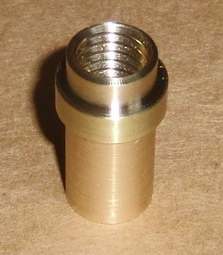

Well, it's not much, but it's a start :)
Dimensions aren't terribly precise, overall length is 28.55mm, diameter forward of the shoulder 12.75mm and diameter behind the shoulder is 13.10mm.... but yay, one small step for JSR... and I still have all my fingers :D
Also, I love this thing!
:D :D :D
Special thanks to LeMaudit for his idiot proof tutorials :)
