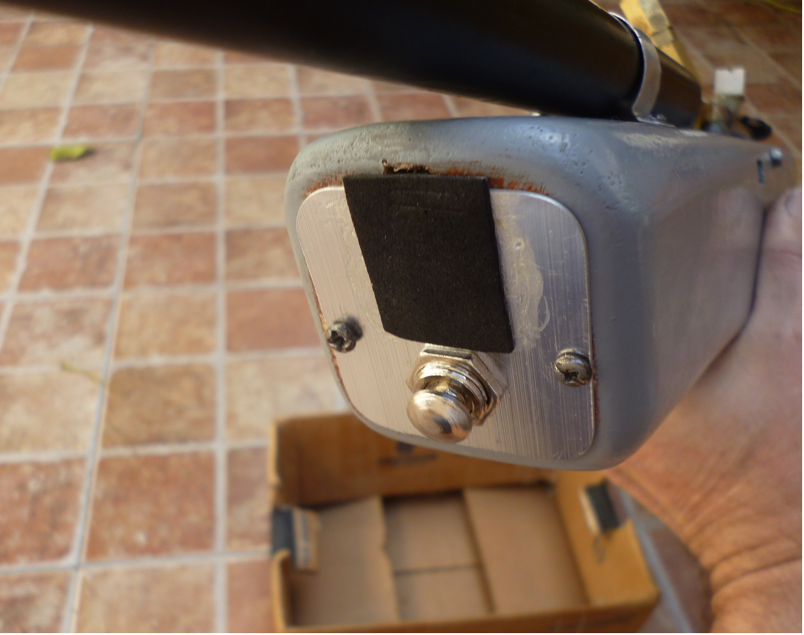

Updating of this project, in this case, the LB VI, (lansa bolillas 6). :)
This prototype is the one that I recently built, which has several important simplifications with respect to the previous one, the first one.
Shoots 5X, .25 caliber steel bbs. The loading in the chamber of the ammunition is automatic, and uses the pressure of the gases to move the bolt back and let the bb pass to be fired.
The ammunition tube holds 11 bb`s. In the front part, it has a microvalve to "remount" the weapon, when the ammunition is already in the chamber. This button is pressed so that it loads the mixture of air and butane. I made it this way, because you can decide for yourself when it's ready to shoot. In the previous model, it was done automatically and you had to be with the gun in your hand, often surrounded by curious friends, distracted myself, ready to shoot if you touch the "trigger", and without shooting... dangerous.
The dispenser is the one I always use, and it burns 3.5 ml of butane with each shot.

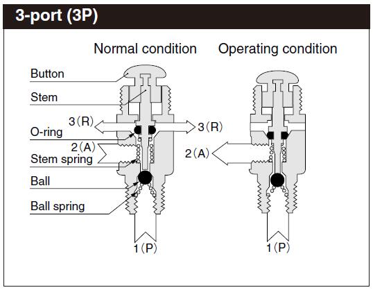

This is the 3/2 micro valve model that I used.

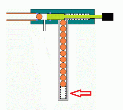

Sistema carga de munición accionado por gases, diagrama, (1).gif (31.55 KiB) Viewed 20396 times

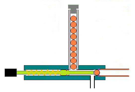

The problem with the automatic loading of balls is that the spring of the tube that houses the ammunition does not survive more than two or three shots because when it opens, the pressure of the explosion expels the bb`s towards the side of the tube cap. destroying the spring, (drawing 1).
The solution is to use the ammunition tube as part of the combustion chamber. In this way, the pressure difference is very small and the bb`s do not move with much energy at the time of the explosion (drawing 2).
When the chamber is compressed, the ammunition tube shutter stem retracts, but not enough to uncover the tube that houses the bb`s. Only when it explodes, it fully retracts and frees the access of a ball to later return by action of the main load spring and press the ball against the retaining o'ring. At the time of precompression, when the stem retracts, the compressed air is responsible for keeping the bb pressed against the retention o'ring, which is what seals the hybrid chamber.
Only the first ammunition is inserted manually, pulling the stem.
Sistema carga munición automático LB VI (2).gif (10.67 KiB) Viewed 20396 times

by hectmarr
I thought it doesn't last much use, but it works very well, up to 10 bar. I'm about to buy the 5-way, two-position one to shrink everything a bit.
