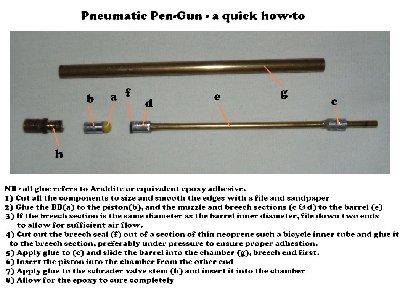

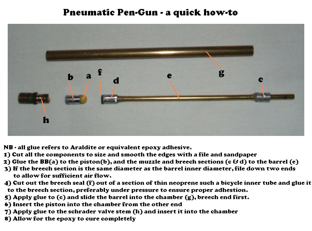

Pneumatic Pen-gun Project
a quick how-to, for any clarifications feel free to ask.

a quick tip: during the 3 times that ive made and remade mine ive found that it easier to take the next pipe size up and make a punch.(eg. i used brass, and the breech section ws 3/16 OD, so i used a 1/4 OD to punch a sealing face, and then used 1/8 [ my barrel OD] to punch another hole in the center)
yep, that's what I did too - take a section of pipe, chuck it in a drill and use a file to sharpen it - then simply place the sharp end over the rubber sheet on a soft surface and hammer away :)

Good news everyone I finally figured out how a piston valve works. Now I can change my sig :lol: And thanks for the how to Jack :thumbright:
