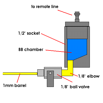

I had a play with the IR sensitive camera, good for low light but useless in bright sunlight...
The gun itself is in progress and curing as per the diagram below, I didn't bother with vortex blocks because the porting is so wide relative to the projectiles that it seems unnecessary, we'll see how justified my mindless optimism is
- sentryaction.GIF (4.98 KiB) Viewed 4755 times

Only testing will prove it's actual effectiveness, but I fear that you might damage your valve especially during moments when the opening isn't large or small enough

The valve will be farily strong, and the bb's wont have accelerated too much by the time they reach the valve so it shouldn't be too much of a problem.
- Posts: 26220
- Been thanked: 352 times
This is what I'm betting on, I'm not really worried about this in this case though it might be an issue with my larger 0.177" version.inonickname wrote:The valve will be farily strong, and the bb's wont have accelerated too much by the time they reach the valve so it shouldn't be too much of a problem.

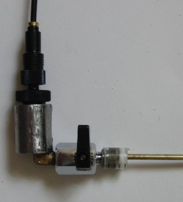

Here's a mockup of the system as it cures:

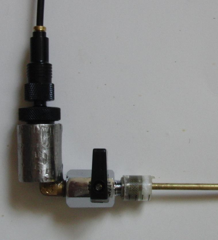

I gave it a whirl and EPIC FAIL
The BBs are so fine that they clogged up immediately, this clearly isn't going to work. Plan B is to build a conventionally laid out minature vortex block with the valve feeding into the chamber as per my original idea, even when half open the 1/8" ball valve has over 12 times the flow of the 1mm barrel so performance should be just as good.

did you try it upside down too, unless the problem is that bad,
I can imagine this vortex block, probably just a thin sheet of plastic or metal, unless you plan to epoxy it too, to get the 1mm bore exit

Upside down the BBs will just fall into the remote line...iknowmy3tables wrote:did you try it upside down too, unless the problem is that bad,
I will probably use a bit of 6mm tubing or something similarly tiny, I also ordered a couple of paintball fill nipples for a lighter setup, so this will be a couple of weeks yet. Still waiting on those darn servos anyway. I'll amuse myself with the 4.5mm variant in the meantime
