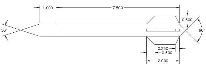

Should I give it another try? I think the main problem last time was the color, a manly color should correct any stability issues.
drex wrote:I think the main problem last time was the color, a manly color should correct any stability issues.
Not making it pink will certainly make it more stable and resistant to damage
A longer looser lighter sabot might also help ;)

See I don't think it's the colour, look at ICBMs, it's the shape and girth that matters.
All males know that if something is more phallic, it will be more powerful. It's instinct.

You used polycarbonate for the tail section, if i'm right?
If you use a hollow plastic tube, the center of gravity will be further forward.

Go with red and a white racing stripe, faster is better :lol:

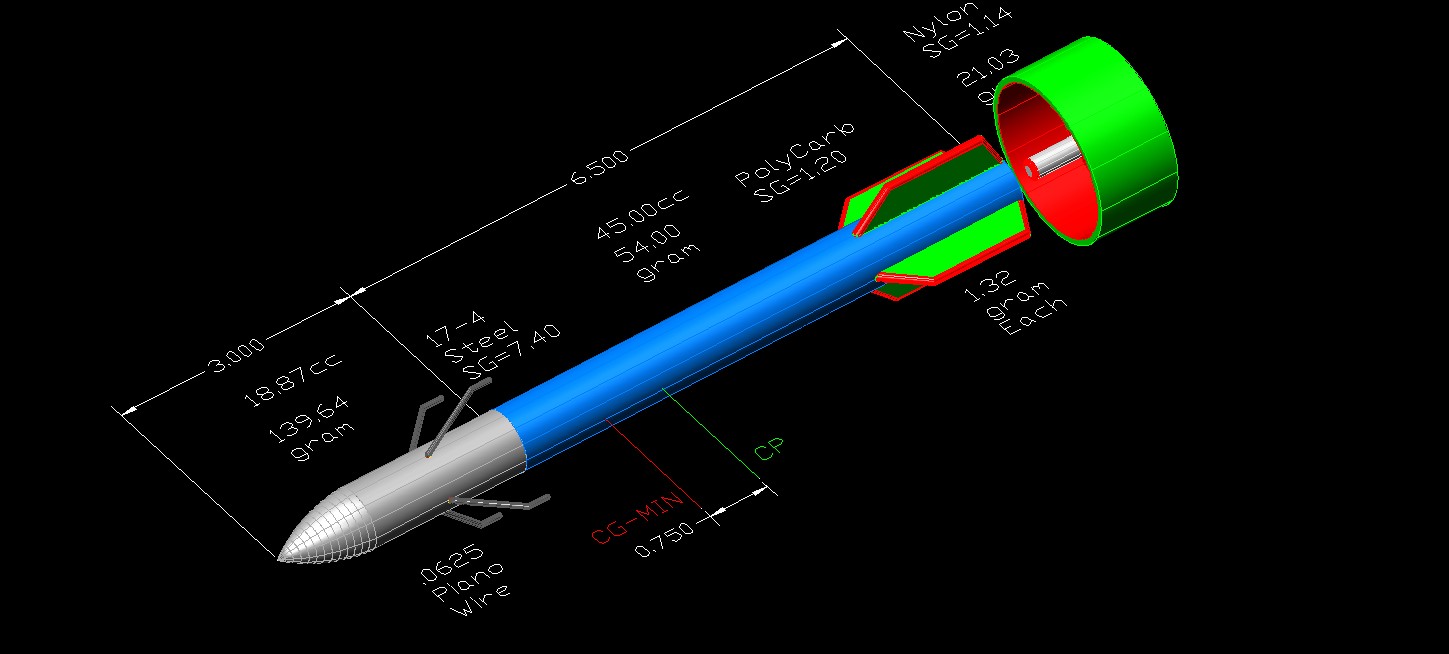

drex wrote:Should I give it another try? I think the main problem last time was the color, a manly color should correct any stability issues.
Here is another version I did for you.
