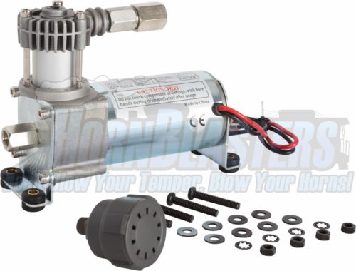

I had the same one, got it up to 120 psi once and it cooked it
These are good for at least 100 psi
https://www.ebay.ca/itm/Viair-92C-Chrom ... c&_ipg=200

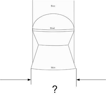

Has anyone got any 0.177 pellets they could get a measurement off. I am looking for an accurate measurement of the skirt, probably need a digital gauge. Something like 4.600mm
