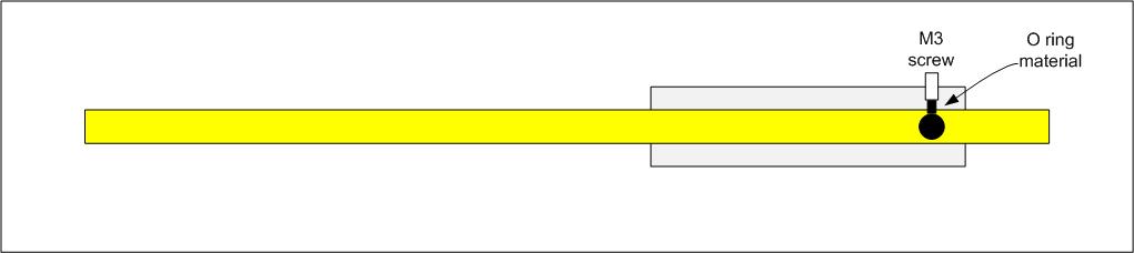

by farcticox1
Would a piece of O ring material work as a hop up ? or would it be too hard ? I need it more to stop the BB's rolling down the barrel as well.
hop up.jpg (16.41 KiB) Viewed 11627 times
Re: Short question topic
Posted: Wed Apr 10, 2019 7:21 am
by jackssmirkingrevenge
It should work, this design is used in several airsoft models.

Posted: Fri Apr 12, 2019 7:06 pm
by farcticox1
Anybody tried this air bleed idea as a hop up ? downside is it bleeds of some air but there is nothing to wear, a rubber sleeve covering the hole could be used as adjustment :idea:
Posted: Sat Apr 13, 2019 12:17 pm
by farcticox1
Tried the rubber hop up thing, it seems to work, at about 120 feet using the scope I can see the BB dip slightly then climb :D
