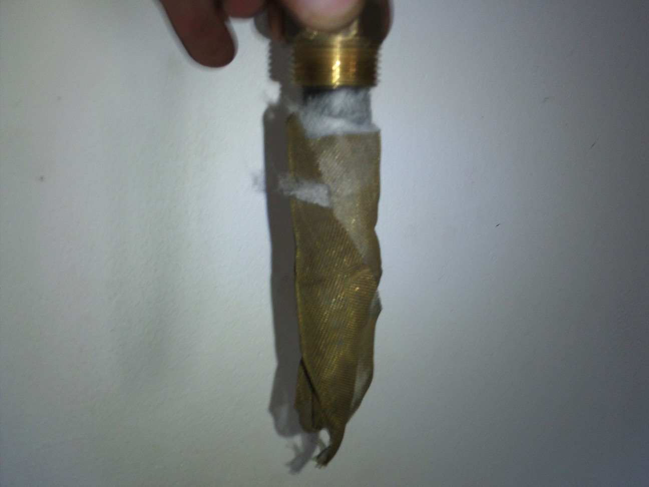

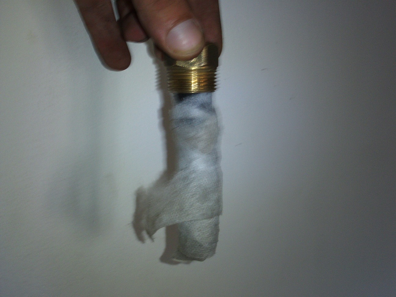

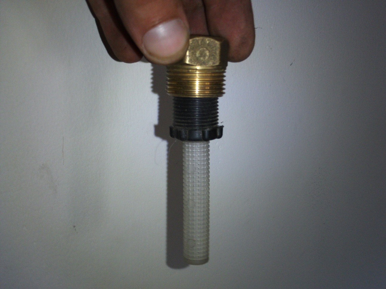

My non-dryer dryer?
I cut it open expecting to find desiccant inside.
All I found was a screen.
I replaced the screen an hot glued an elbow on the chamber to prevent junk/ater from getting inside.
FWIW
BoyntonStu
boyntonstu wrote:My non-dryer dryer?
FWIW
BoyntonStu
On a refrigeration system the dryer is most often placed after the condenser so liquid flows through it right before the expansion valve or capillary tube so it catches any junk that may plug up the small orifice. The tank you cut on the compressor is either an oil separator or an accumulator.
An accumulator is used on some air conditioners to adjust the amount of freon in circulation. On cooler days the freon will operate at lower pressure, so less gas mass is used and the system may have too much liquid. It collects in the accumulator. On hot days the system pressure is higher which requires more freon, so the accumulator boils off the freon and provides the additional pressure required so the expansion valve doesn't run out of liquid. With the screen, it may just be an oil separator. An oil separator will have a 3rd tube connected to it to return oil to the crankcase. A filter dryer only has two tubes connected, an in and out.

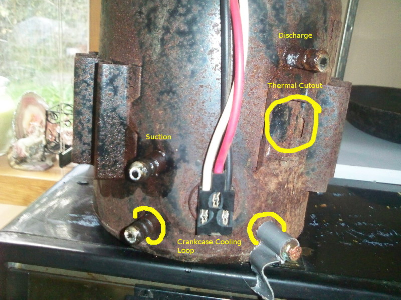

heres some more images of the compressor,
This one is the manufacture tag, ill try some photoshop in a sec to see if i can read it better
the side showing all 4 connections and power
and showing how the "Heat sync" was attached, i tipped it over for a second and oil spilled out so i think im going to reattach, or just seal it

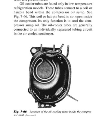

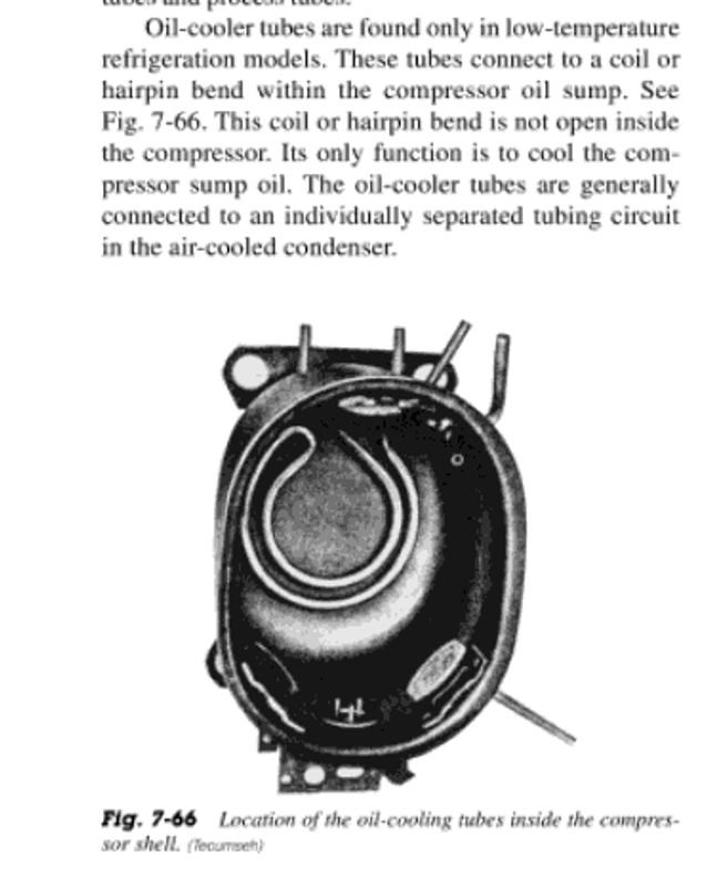

I made some edits to your pics to show the connections. I also located a cut open view to show the crankcase cooling loop. The small "Heatsink" is for crankcase cooling and is the individually separated condenser tubing circuit mentioned in the photo with the cooling tube.
As to where the starting relay is located, it is located on the other end of the wires in this model with the start cap and maybe a run cap. The book where I found the cooling loop pic has more information.
I hope this helps.

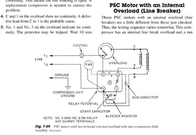

Screen captures stolen from here;
http://books.google.com/books?id=Sbu_X1 ... q=&f=false

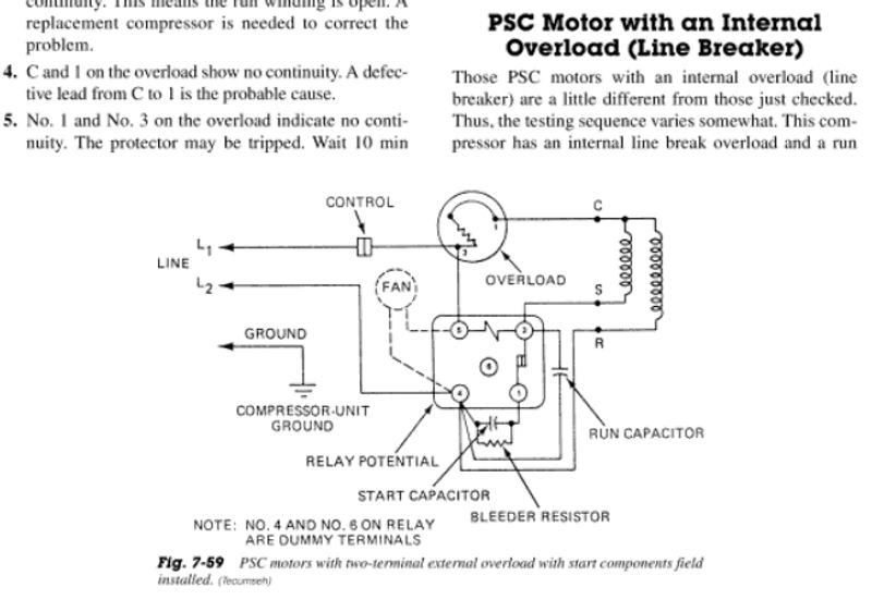

One of several relay and capacitor start/run connection combinations.  Not all compressors have the start relay on the compressor.  Some don't use a start relay and only use a run and start capacitor.
Oil Cooler in the compressor

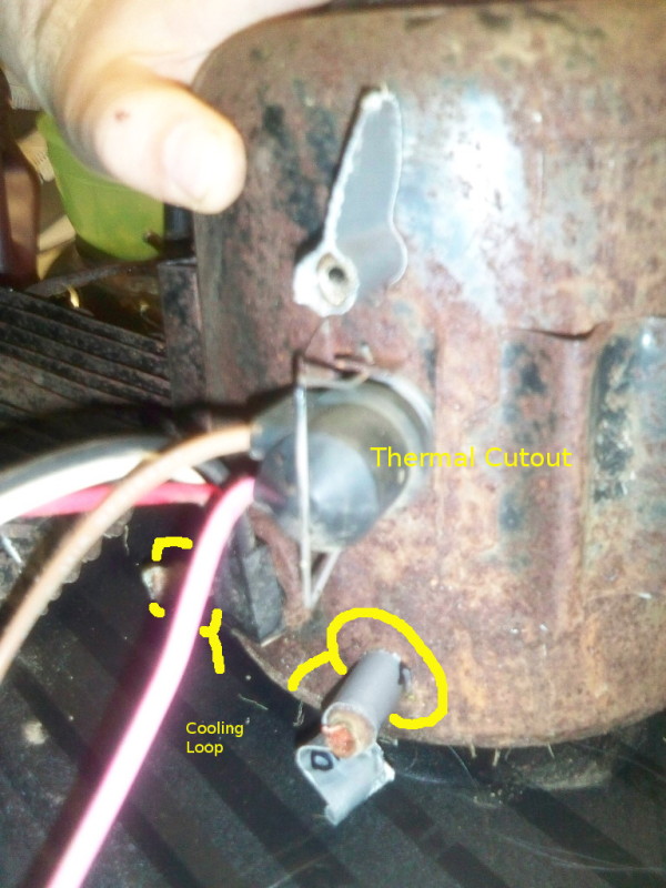

More info.  Photo rotated to match the other photos orientation.  It was confusing at first.
Cooling loop connections and locations of cut out.

You don't need to reattach the cooling loop. The fins work just fine. The cooling loop is to keep the compressor cool when running 24 X 7. Intermittant use should be no problem. We use lower inlet pressure. We don't use freon so you won't get much benefit running just a little air through the loop. The fins on the case will keep it cool just fine.

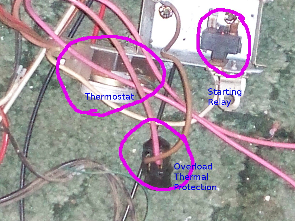

Without the starting stuff, it won't start. It may hum, but it won't rotate and start pumping. You need to see if you can properly connect the starting cap, start relay, overload, etc. I hope you made a diagram before disassembly. The book in the link may provide your diagram. It would pay to examine the fridge to see if it still has a wiring diagram attached. Some do.
Components identified.
