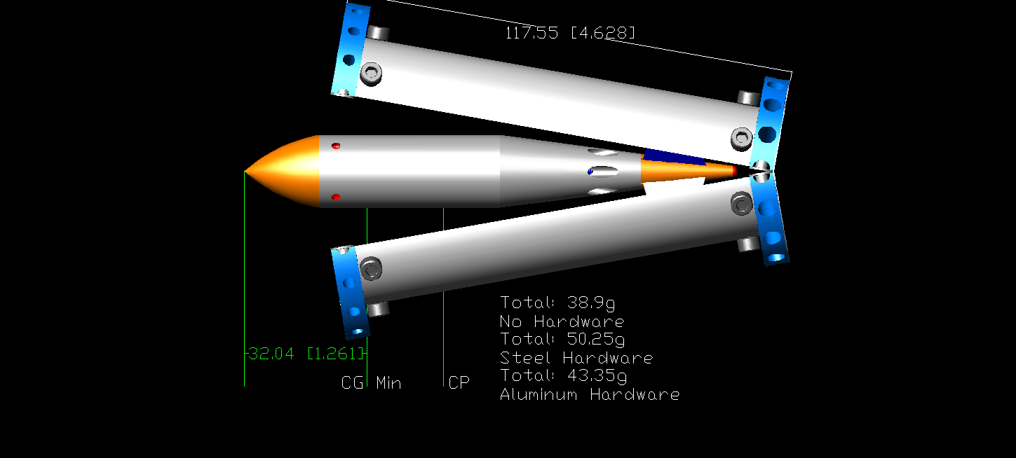

The only improvement I could think of, would be to add something to help aerodynamically force the petals apart when firing it as a seperating sabot.
Something like the front of this sabot...
Now, I'm not familiar with these rounds, so I don't know if sabot seperation is caused by some kind of triggered charge, or simple aerodynamic forces... But it looks like the shape of the sabot is designed to allow the airflow to pull it away from the projectile cleanly.
It was my first idea too, but after some thinking and taking into account some KISS arguments :-) I finally agreed that it made little sense; the material UHMW is so slippery that there's really no friction to release.
If the projectile had been hold in the sabot with some pins or grabbing points, maybe it would have been necessary to quickly free those pins. For that particular shape, I think it's fine like that. (but if it WAS necessary after all, I want to make it clear that it's all dewey1's fault :angel9: )

MrCrowley; Make sure to add weight to nose end such that the balancing point of MiniBoy is as shown here. About 32 mm maximum from nose tip.

Any plans to reduce the overall weight?
Nah. I'm afraid that the thing would broke under too much stress, or deform enough to make it unusable. I wish the sabot could sustain at least a few launch. What are a few grams in life anyway? Seriously, I can thin parts, but only for a few grams. I'm not sure it worth it. And I don't know how to be sure of that really. Someone?
You need to remove another 6 grams to be the same weight as my proposal. The sabot is for MiniBoy and not FatBoy!

LeMaudit wrote:Seriously, I can thin parts, but only for a few grams. I'm not sure it worth it. And I don't know how to be sure of that really. Someone?
Every gram less on the sabot means more fps and more range. What happened to all the holes you were meant to drill in it ;)

Could turn a polypropylene sabot with a cup in the front and cut it in 3 sections.
I know that... but will it be significant for say, 3% of the sabot mass?
What happened to all the holes you were meant to drill in it Wink
There's much more cuts and grooves than the original design :tongue1:
But if a few % is significant, I'll shave and drill the beast :D (oops... can I say that?)
Give me some numbers someone! :lol:
[edit] sabot weight as posted before is 49.6 grams for the separating sabot, 54 grams for the cup sabot.
MiniBoy is 68.4 grams empty. It could be filled I guess with 50 to 70 grams of additional weight

LeMaudit wrote:Give me some numbers someone! :lol:
MrC can model it in HGDT, give him a range of sabot weights.

I was thinking about doing a decent distance calc as well, I think we would have only two estimated variables which would significantly alter the results: Cd and wind.
I'm not sure how we could calculate or even estimate the Cd of LeMaudit's projectile and a Cd varying by only 0.01 (or something like that) could change the range by up to 1000m + or -. I know wind has a significant effect on projectiles with a poor Cd like a golf ball but i'm not sure about projectiles which are very aerodynamic, but again, it could significantly change the range calculations.
MrCrowley wrote:I know wind has a significant effect on projectiles with a poor Cd like a golf ball but i'm not sure about projectiles which are very aerodynamic, but again, it could significantly change the range calculations.
As you know, air drag increases exponentially with velocity, and wind changes the velocity of the projectile relative to the air, so its effects will be significant.
My suggestion is to fire in line with a known landmark or compass heading, ideally when the wind is right behind you to prevent drift. This means you can limit your search to a relatively narrow strip (less than 20 metres wide depending on wind) with the only variable being range, and of course you can use a rough range estimation to eliminate say the first couple of kilometres. Google maps could be a variable tool to determine an ideal launch site and the estimated landing zone, heck it wouldn't be the first time :roll:

If you can get the projectile in sabot to me in dwg, dxf(with blocks for the materials), or iam, I can run it through a FEM program.
