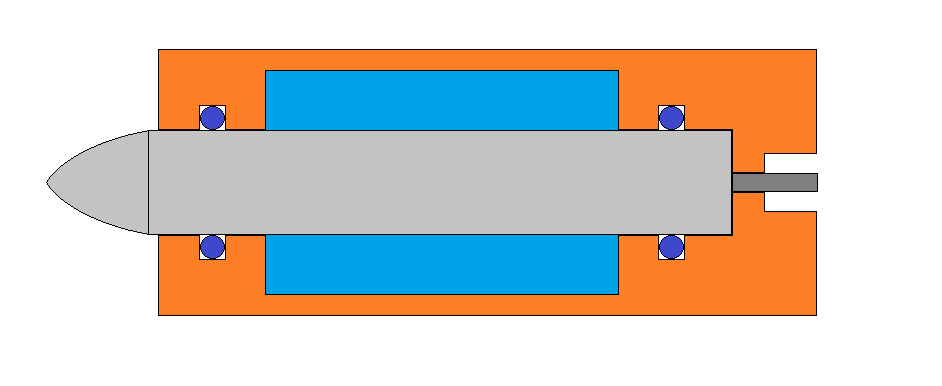

I envision the use of a buffer chamber as in the diagram below, that way the cartridge can be as small as possible and just be a "carrier" for the projectile:

the chamber has a volume of 155cm3 and I pressurized to 60bar.
So every shot should receive the same amount of air
