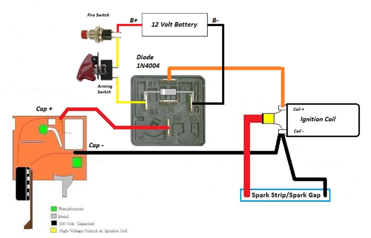

it does not work?
I did a lot of research and I do not remember where I got it ... :oops:
dewey-1
Posts: 1298
Location: NE Wisconsin USA
The Wiki shows a how to.
I will do a correct diagram for you!

it's nice!
thank you !

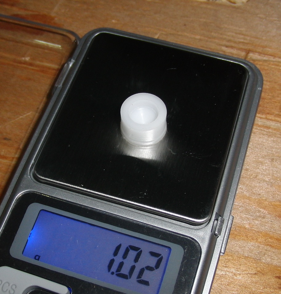

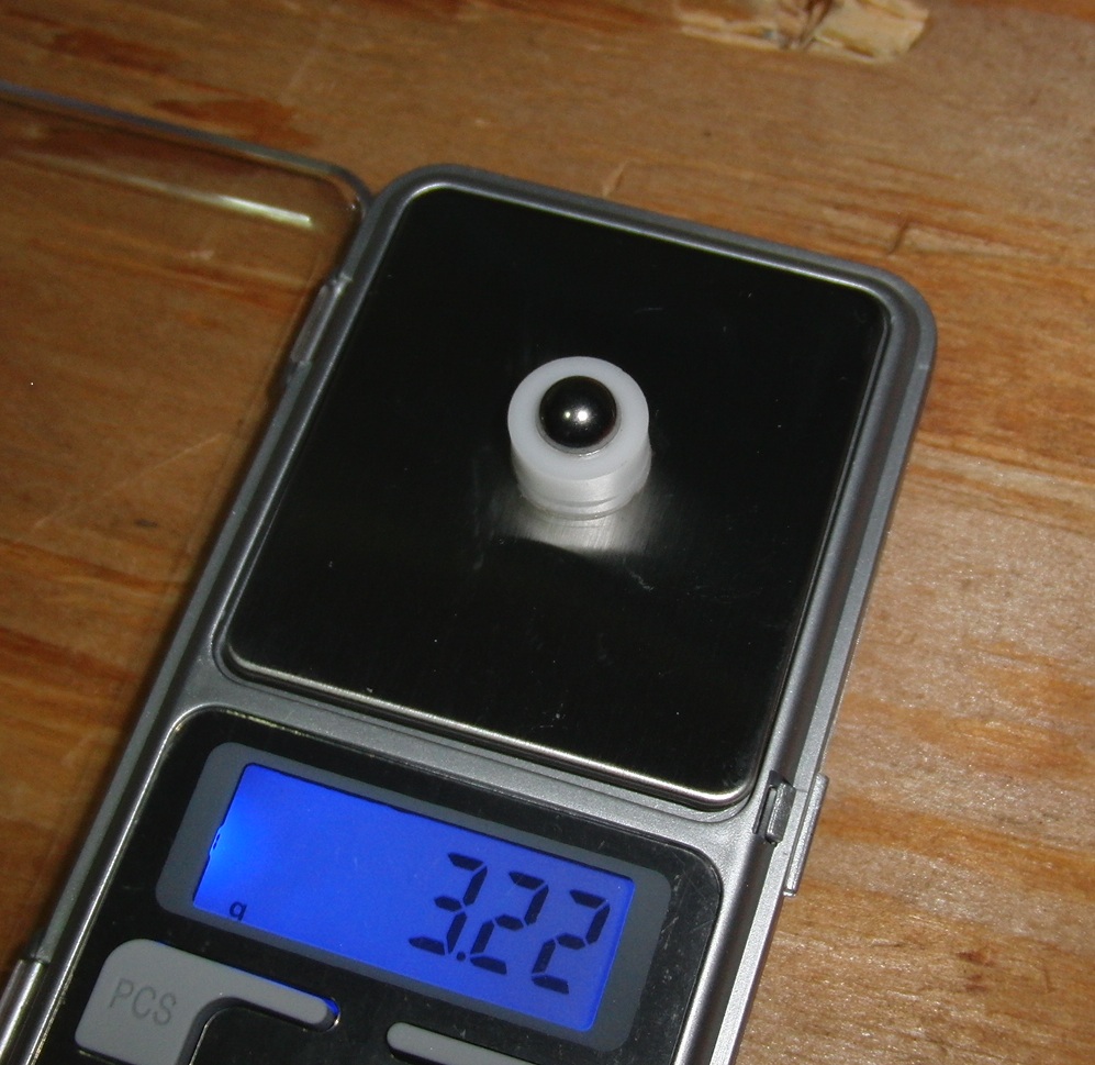

Here you go, some sabots for your 8mm BALLS OF STEEL!
:D

The problem is that this design won't really separate. It's probably best if I make some in three parts, one "pusher plate" and two "petals" to hold the ball. That way you will have a better change of recovering them for re-use.

If the ball is lightly glued, to the output of the barrel the sabot will go, no ?
3 part is more complicated and lengthy to make...

With the force of the acceleration, the ball will dig into the sabot and will not separate.
Not too complicated to make a three part one, I have a slitting saw on the mill :D not today though, got some other stuff to work on.

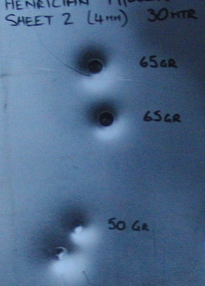

In the meantime, dug up a test on 2 x 2mm steel sheets with a 1540 0.50 calibre black powder musket.
This is the second sheet, at 1150 feet per second the lead ball penetrated the first sheet and dented the second (the two shots at the bottom of the picture). The top two shots were penetrations of the two sheets with an increased powder charge at 1330 feet per second.

the difference is astounding and low ft/s separate them !
Posts: 26220
Been thanked: 352 times
Don't forget:
In this case, the second shot is 16% faster, but it has 31% more kinetic energy.

Here is a correct wiring diagram for a 12 VDC Automotive Type Relay.

Ah nice clear schematic dewey-1 !
