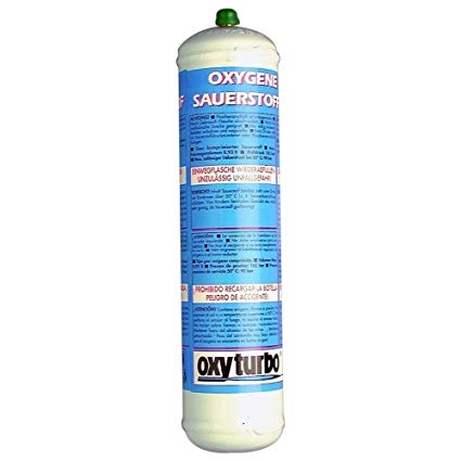

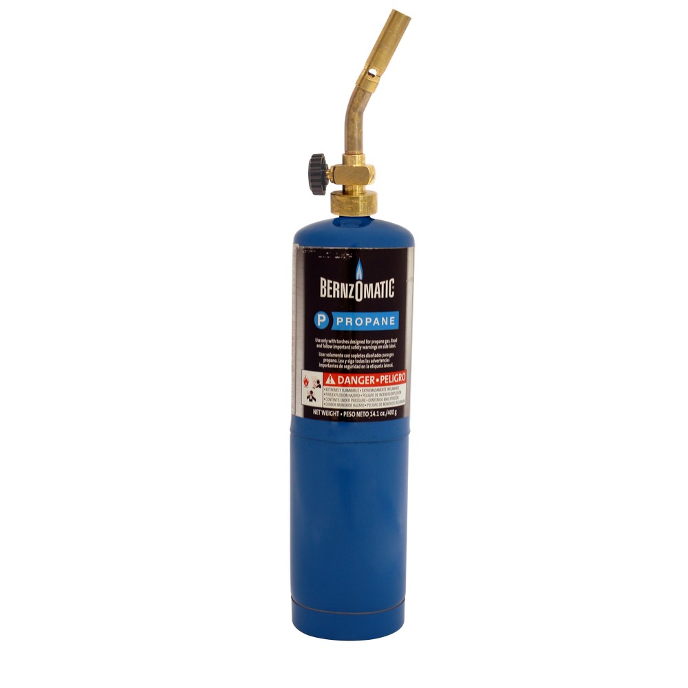

Oh yeah! These guys have not analyzed enough the weapon ... :? Without introducing the ammunition, so that the burned gases escape and so that there is no pressure higher than the atmospheric inside the weapon, while you load the mixture, it can work, even without any valve . Press the valve of the bottle and let the mixture run for a few seconds through the inlet, where the hose is connected, and let out the barrel a little. Then, you enter the ammunition, press the lighter and boom! :bom: , assuming stoichiometry is correct, which I think is this way.
The solution is good, it seems simple and effective, but the operation of the weapon, in the video is incorrect. Likewise, nice weapon and system. :)
I would try it in a smaller gun size, but with a mixture of oxygen and propane, (without logically compression), and I think it should work, and with enough power. Safety is guaranteed because oxygen and propane are separated into two small bottles. This adds a little "spicy" to the weapon, for which we have a little experience. :twisted:

Oh my god, of course you don't need a valve, lol. I thought they needed one, but I don't know why I thought their chamber was sealed and air tight. With no projectile, it's open. I'm looking forward to your oxygen propane fun. Keep us posted!
