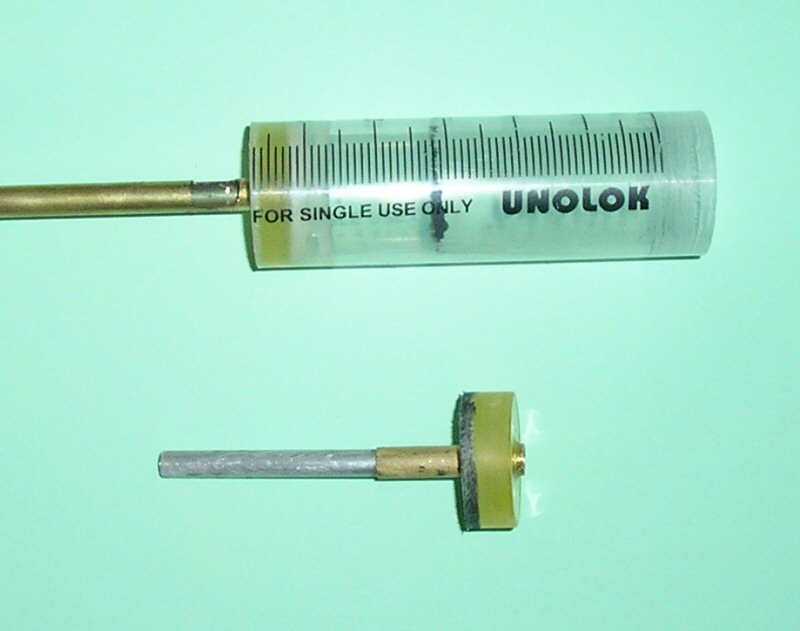

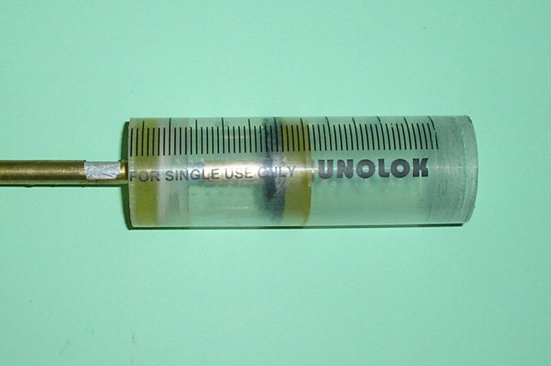

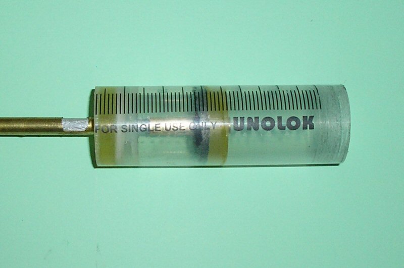

here's a few prototype photos to whet your appetite
Of course the syringe tube isn't pressure rated but I'm taking my chances for now, I can reinforce it later if the system works.

why not use brass tubing jack? youd get lower friction.......... therefore more efficient bolt system.......
anyways, that looks greater than great. i hope to see the finished project...........
You don't have to wait long, the last pouring of epoxy is curing and it should be ready for testing within 24 hoursVH_man wrote:....anyways, that looks greater than great. i hope to see the finished project...........
