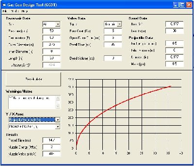

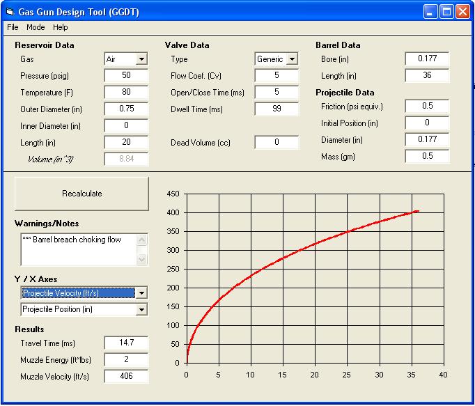

Ok, here's my imaginary launcher, and the results I got when I played with the variables:
20 inch chamber at 50 psi - 406 feet per second
10 inch chamber at 100 psi - 537 feet per second
5 inch chamber at 200 psi - 684 feet per second
2.5 inch chamber at 400 psi - 830 feet per second
1.25 inch chamber at 800 psi - 958 feet per second
0.625 inch chamber at 1600 psi - 1006 feet per second
All the time, we're talking about the same quantity of air, because we're doubling the pressure but halving the volume.
