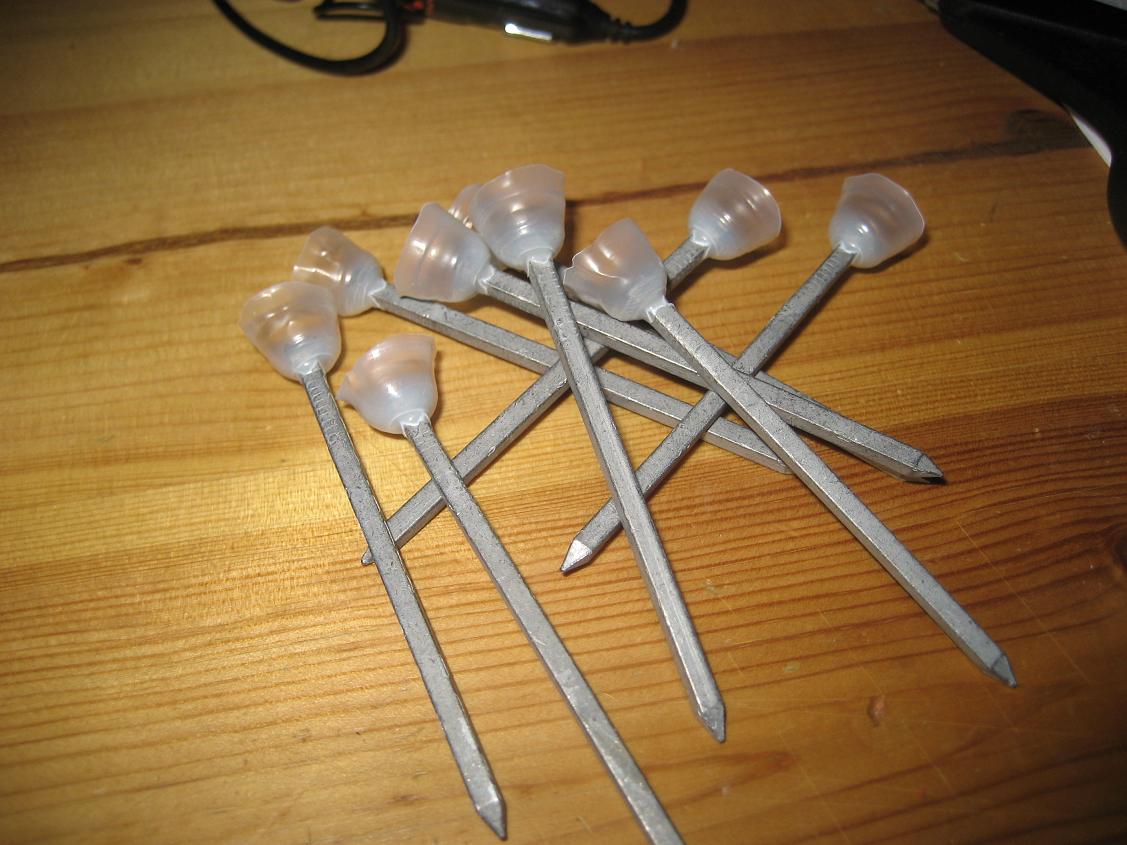

Mate they are some really nice looking darts. What did you use for the tail? I'm thinking you made a mould, pushed the nail in and just poured in hot glue? (it looks like hot glue or something similar) :D
Great looking gun, keep up the great work!
By the way, with your blowgun, how did you attatch it via the nozzel? isn't it a different thread? One more question mate... Does your blowgun hiss and leak? I was told that when they are hooked up backwards, they leak pretty bad :?
hyldgaard
Posts: 187
Joined: Tue Sep 25, 2007 4:21 am
Location: Denmark
thanks :wink: I used some other guys from this forum as inspiration, but really cant remember who :? the tail is made from heated milkjug, pressed down over a laserpointers head. I have some pictures i can upload when i get back home that illustrates the process a little better, but generally its kind of a mix between different homemade darts i saw on the forum, just made easier to "mass produce". but i dont take any credit since almost none of the ideas were mine :wink:

Very nice gun indeed, i appreciate your point and aim method too as it is the way i aim :wink: The darts you made seem to work quite well also.

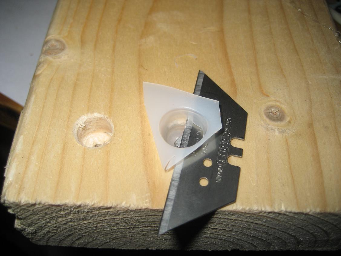

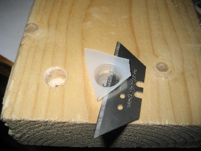

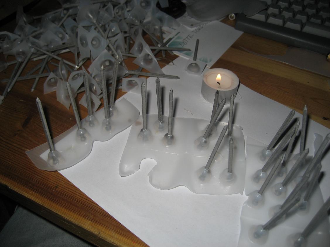

Milkjug heated until clear, then pressed onto the laserpointers head, which is resting on the table. when hardened, nail is pushed into the cone.
I use a wooden block with two holes in it to cut the cones consistently, one hole that fits the diameter of the nail that goes  all the way through, and a whole with the ID of the barrel +1mm to make a tight fit. note that the last hole only goes as deep as the cone has to go before it rests on the edge. (if you dont understand what the h im talking about, please tell me. im not very good at the english explanation ;))

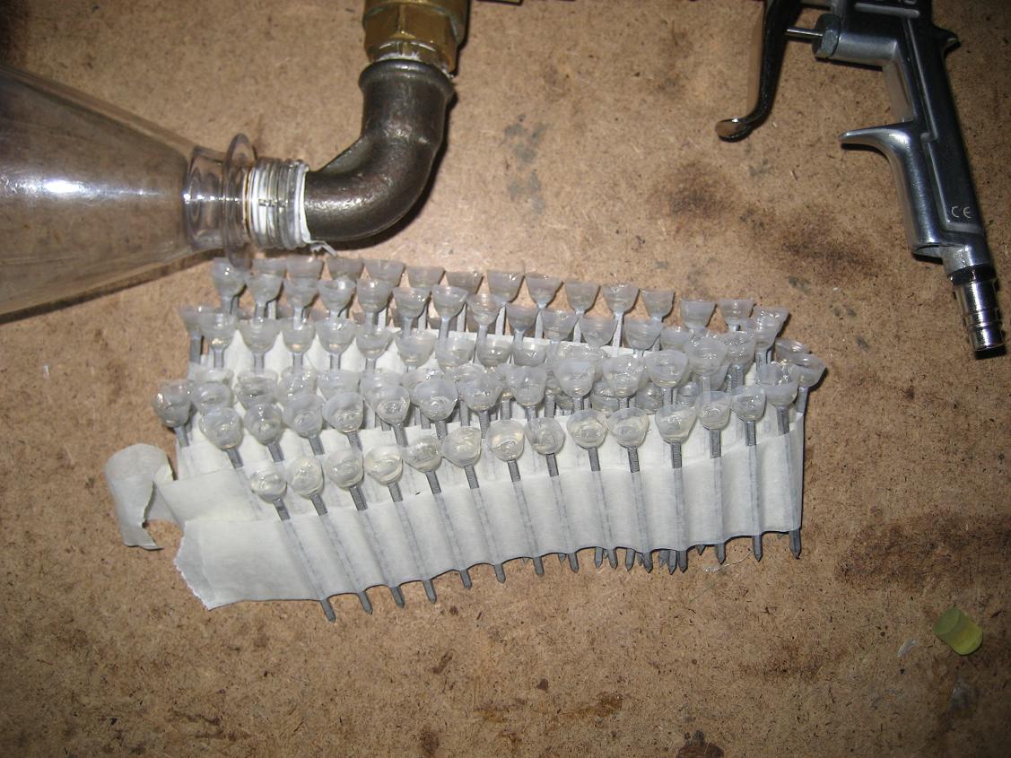

now put as little hotglue in the bottom of the cone as possible, while still covering the head of the nail.
I keep them wrapped in masking tape, to keep track of them :D
