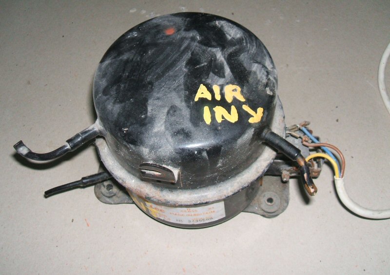

I will try to write how to remove them and use them as compressors and put that in how-to section (but i am not promissing anything)...
One more thing.. you must remove the part that starts the compressor when temperature rises in refrigator - it is a small box with cables stiking out of it (sorry but expressing technical details in foreign language is more difficult than I thought it can be
Here is a link to Polish site where u can see how to remove a compressor from a fridge/refrigator http://www.modelarz.one.pl/index.php?porady=kompresor (yes, it is in polish
but you can use pics to get the idea how to do it)
WARNING These compressors usually don't have any pressure switches - they will pump as long as they are connected to the power - don't forget to add a pop-of valve or something similar. I've heard that it can pump to 35 bar (490 psi) and possibly even more
JSR - have you tried using your compressor to pump anything? or at least attaching a pressure gauge to it ? - these things have small flow but can give you high pressure - ideal for small sized chamber/high pressure guns - in fact the sound they make can be compared to
so it is possible that your compresor is okbaby farting

When i try shaking mine it rattles too... try to attach air hose to it and see wheather it can pump to some pressure.
