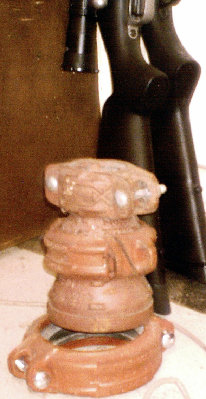

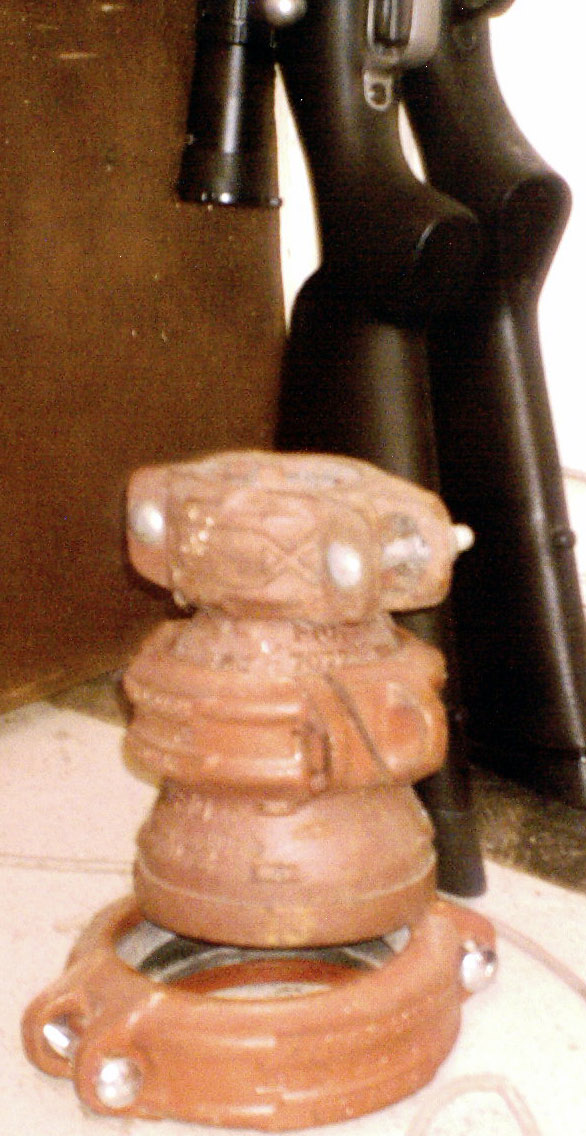

If your open to victaulic
http://www.victaulic.com/content/
i have a few fittings .
and rigid lock couplings.
unfortunately no 4" caps
4" coupling to 4x3, 3" coupling to 3x2 ,2" to 2" cap.
their listed working pressure is 750 psi
3 in gasket is no good and needs replaced
they're yours if you want them.
p.m. a place to ship them.
roll grooving your pipe doesn't weaken you pipe or remove material from it
vic fittings are the norm in fire sprinkler systems and every job should have a grooving machine set up on it .
maybe buying lunch for a sprinkler guy could get him to do 2 minutes of work?and slip you a 3" gasket? or trade reducers for a 4" cap?
