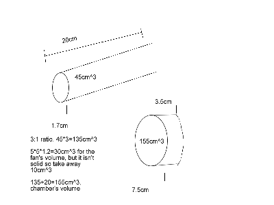

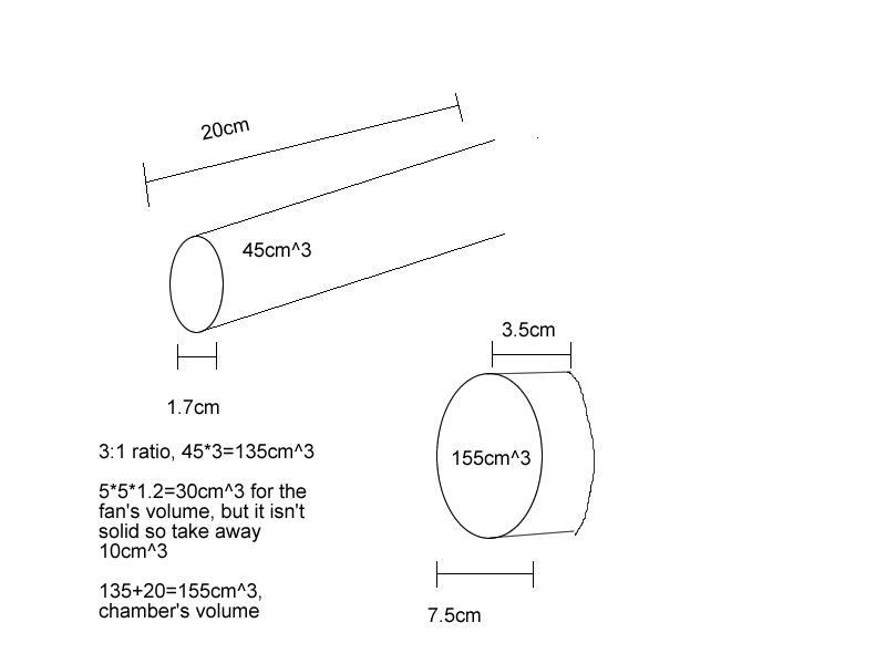

Indeed it will be made of copper, I wil have to check the availability of the sizes I am looking for... (plans are a bit crude indeed :P )
now fitted with a 5cm fan, total chamber volume is 3 times the barrel plus the approximate fan's volume.

I havent seen a copper combustion before, should be interesting.
Zen/// wrote:I havent seen a copper combustion before, should be interesting.
I wouldn't think a metal combustion is a better idea, as the body would betterabsorb some of the heat of the ignited gasses and therefore lower your pressure somewhat.
